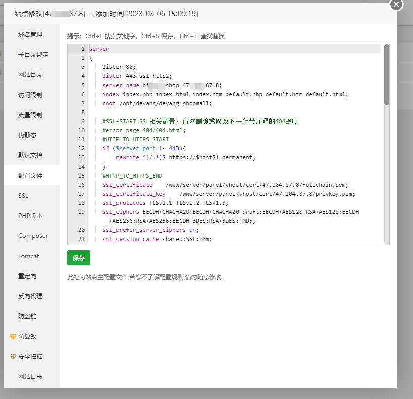

面板、插件版本 面板 [url=]7.9.8,[/url]nginx 1.22.1
问题描述:反向代理后访问链接地址报HTTP Status 400 – Bad Request
目标地址是可以正常访问的

#PROXY-START/f/api/
location /f/api/ {
    proxy_pass http://ip:8084/;
    proxy_set_header Host http://ip:8084;
    proxy_set_header X-Real-IP $remote_addr;
    proxy_set_header X-Forwarded-For $proxy_add_x_forwarded_for;
    proxy_set_header REMOTE-HOST $remote_addr;
    proxy_set_header Upgrade $http_upgrade;
    proxy_set_header Connection $connection_upgrade;
    proxy_http_version 1.1;
    # proxy_hide_header Upgrade;
    add_header X-Cache $upstream_cache_status;
                #Set Nginx Cache
    if ( $uri ~* "\.(gif|png|jpg|css|js|woff|woff2)$" )
        expires 1m;
    proxy_ignore_headers Set-Cookie Cache-Control expires;
    proxy_cache cache_one;
    proxy_cache_key $host$uri$is_args$args;
    proxy_cache_valid 200 304 301 302 1m;
#PROXY-END/f/api/
加上空格也不行
