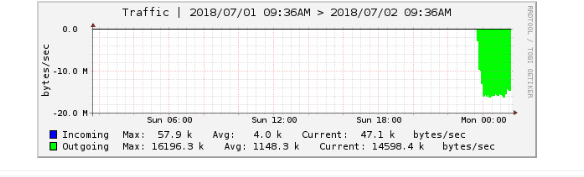

随后,查看网络状态,上行异常,如图:

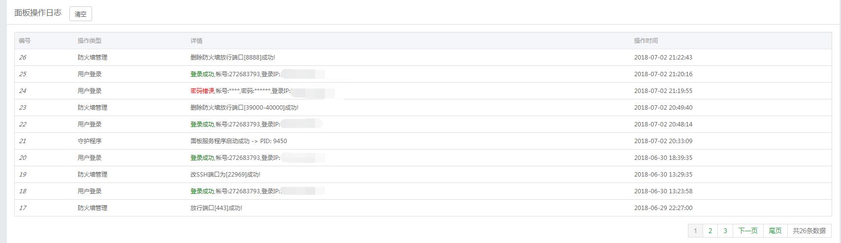

是的,我机器也出现这个情况。最后封掉了2个IP
45.79.165.248
139.162.179.70
无图无真相

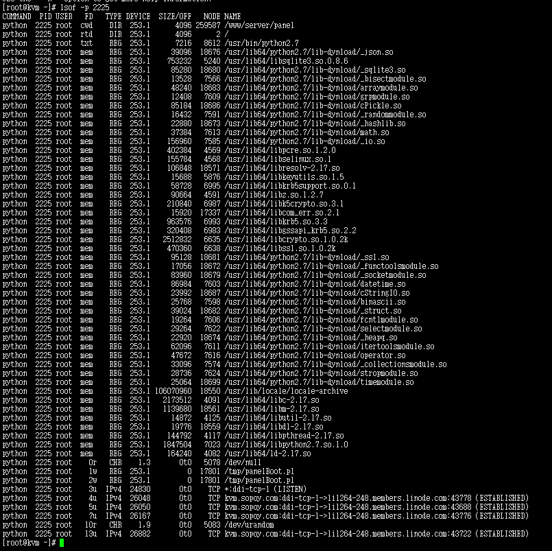

[root@kvm ~]# netstat -atunlp
Active Internet connections (servers and established)
Proto Recv-Q Send-Q Local Address           Foreign Address         State       PID/Program name
tcp        0      0 0.0.0.0:443             0.0.0.0:*               LISTEN      888/nginx: master p
tcp        0      0 0.0.0.0:3306            0.0.0.0:*               LISTEN      1600/mysqld
tcp        0      0 0.0.0.0:80              0.0.0.0:*               LISTEN      888/nginx: master p
tcp        0      0 0.0.0.0:21              0.0.0.0:*               LISTEN      847/pure-ftpd (SERV
tcp        0      0 0.0.0.0:8888            0.0.0.0:*               LISTEN      919/python
tcp        0      0 0.0.0.0:888             0.0.0.0:*               LISTEN      888/nginx: master p
tcp        0      0 127.0.0.1:25            0.0.0.0:*               LISTEN      1280/master
tcp        0      0 0.0.0.0:22969           0.0.0.0:*               LISTEN      788/sshd
tcp        0 376197  **************:8888     45.79.165.248:60634     ESTABLISHED 919/python
tcp        0 376197  **************:8888     139.162.179.70:58866    ESTABLISHED 919/python
tcp        0 376197  **************:8888     45.79.165.248:60636     ESTABLISHED 919/python
tcp        0 376197  **************:8888     45.79.165.248:60640     ESTABLISHED 919/python
tcp       82      0  **************:8888     45.79.165.248:60638     ESTABLISHED 919/python
tcp        0 376197  **************:8888     139.162.179.70:58868    ESTABLISHED 919/python
tcp        0  31930  **************:8888     139.162.179.70:58874    ESTABLISHED 919/python
tcp        0 376197  **************:8888     45.79.165.248:60632     ESTABLISHED 919/python
tcp        0      0  **************:36436    162.219.124.176:35601   ESTABLISHED 848/python
tcp        0 376197  **************:8888     139.162.179.70:58870    ESTABLISHED 919/python
tcp        0 376197  **************:8888     139.162.179.70:58872    ESTABLISHED 919/python
tcp        0     52  **************:22969    **************:63764     ESTABLISHED 1809/sshd: root@pts
tcp6       0      0 :::21                   :::*                    LISTEN      847/pure-ftpd (SERV
tcp6       0      0 ::1:25                  :::*                    LISTEN      1280/master
tcp6       0      0 :::22969                :::*                    LISTEN      788/sshd
udp        0      0 127.0.0.1:323           0.0.0.0:*                           431/chronyd
udp6       0      0 ::1:323                 :::*                                431/chronyd

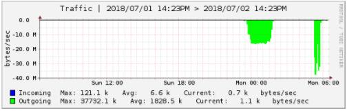

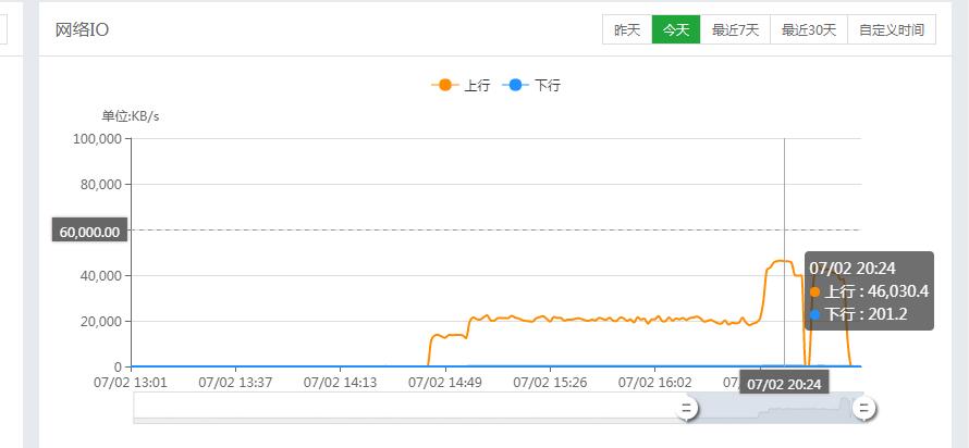

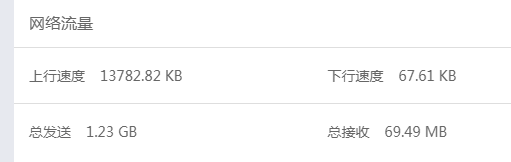

再上两张图
