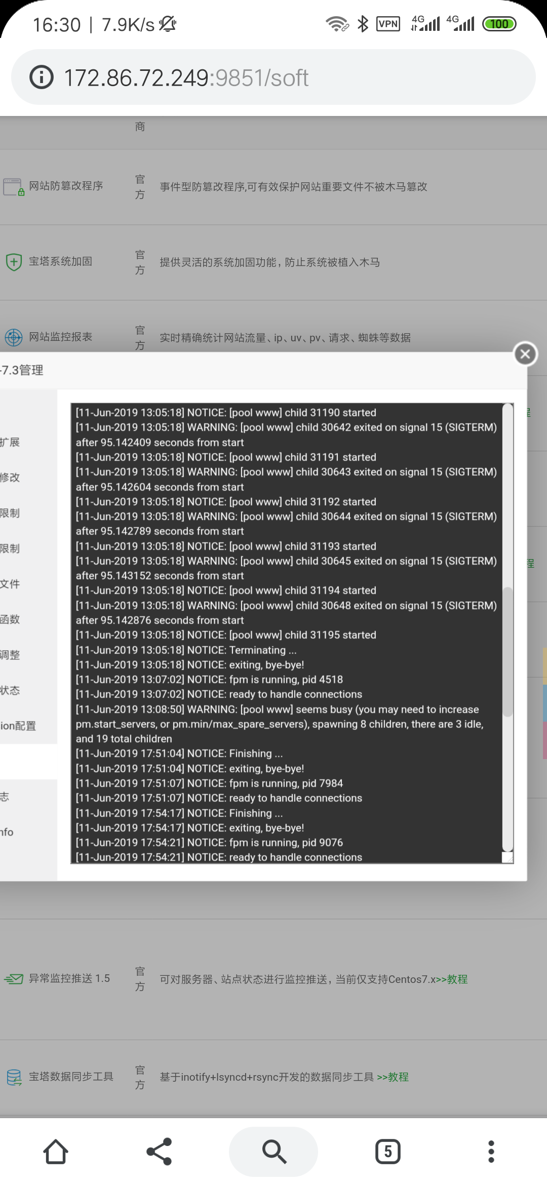

发表于 2019-6-12 11:37:52 | 显示全部楼层

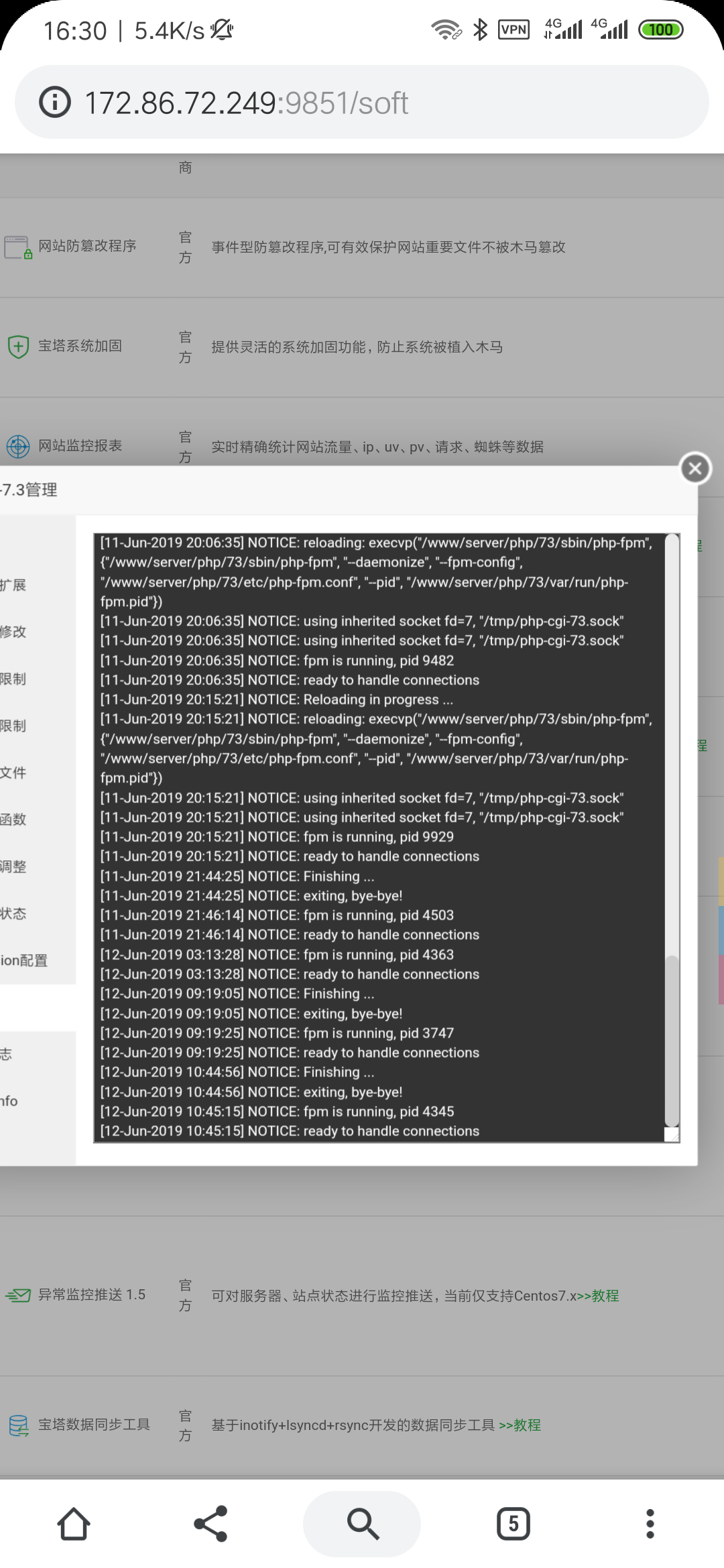

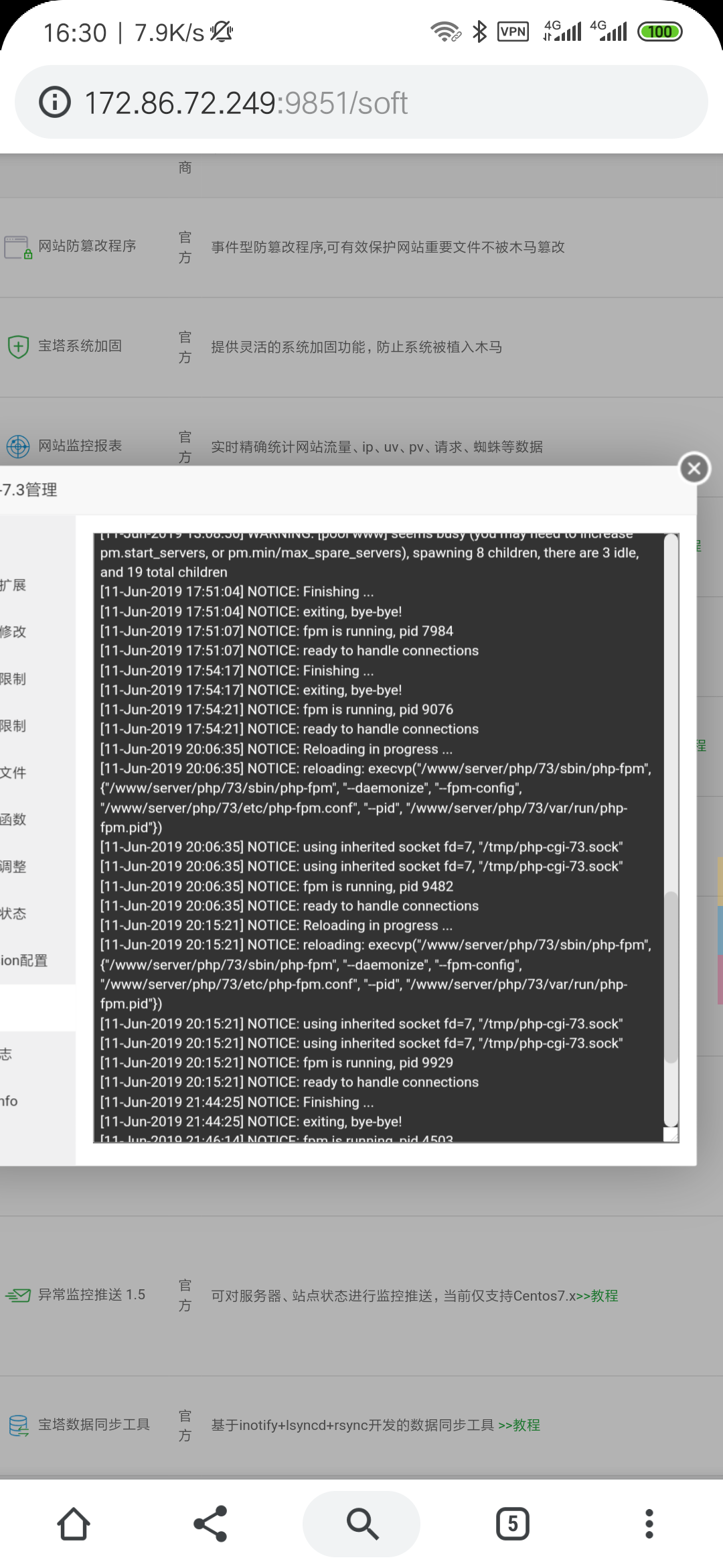

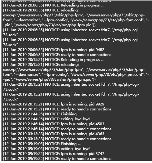

可以更新。错误日志截图多点。
发表于 2019-6-12 16:35:11 | 显示全部楼层
日志只能截这么多

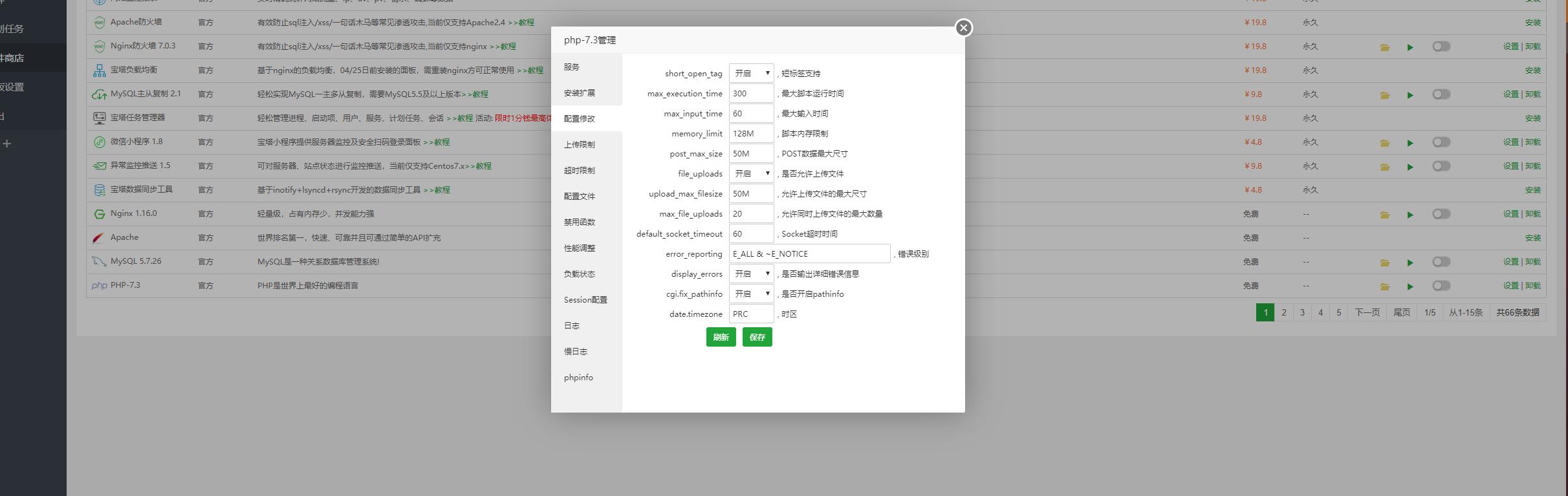

我对系统做的更改只有加了一个google bbr,然后更新了内核到最新版,php的上传配置改了最大上传文件2g,其他也没改改动过任何东西啊

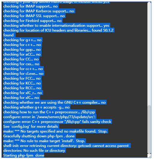

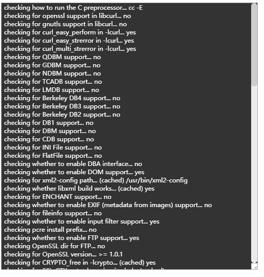

发表于 2019-6-12 18:01:06 | 显示全部楼层

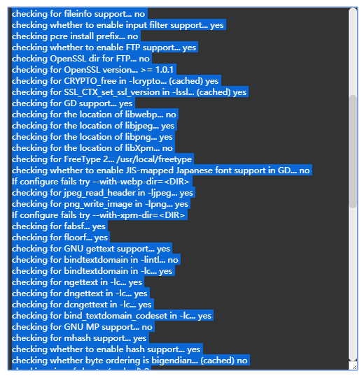

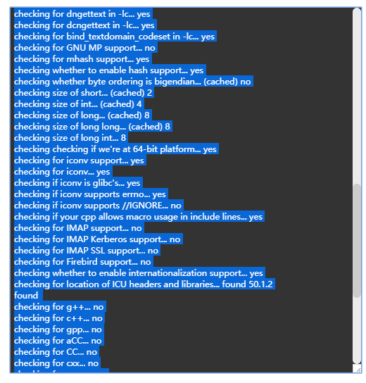

不是这个日志 是左上角安装任务列表的执行日志
发表于 2019-6-12 18:14:28 | 显示全部楼层
发表于 2019-6-12 18:30:14 | 显示全部楼层
checking how to run the C preprocessor... cc -E

checking whether g++ accepts -g... no
checking how to run the C++ preprocessor... /lib/cpp
configure: error: in `/www/server/php/73/update/src':
configure: error: C++ preprocessor "/lib/cpp" fails sanity check
See `config.log' for more details
make: *** No targets specified and no makefile found.  Stop.
Gracefully shutting down php-fpm . done
make: *** No rule to make target `install'.  Stop.
shell-init: error retrieving current directory: getcwd: cannot access parent directories: No such file or directory
Starting php-fpm  done
以上是执行日志,只能复制这么多

cc: error: Zend/.libs/zend_language_scanner.o: No such file or directory
cc: error: Zend/.libs/zend_ini_parser.o: No such file or directory
cc: error: Zend/.libs/zend_ini_scanner.o: No such file or directory
cc: error: Zend/.libs/zend_alloc.o: No such file or directory
cc: error: Zend/.libs/zend_compile.o: No such file or directory
cc: error: Zend/.libs/zend_constants.o: No such file or directory
cc: error: Zend/.libs/zend_dtrace.o: No such file or directory
cc: error: Zend/.libs/zend_execute_API.o: No such file or directory
cc: error: Zend/.libs/zend_highlight.o: No such file or directory
cc: error: Zend/.libs/zend_llist.o: No such file or directory
cc: error: Zend/.libs/zend_vm_opcodes.o: No such file or directory
cc: error: Zend/.libs/zend_opcode.o: No such file or directory
cc: error: Zend/.libs/zend_operators.o: No such file or directory
cc: error: Zend/.libs/zend_ptr_stack.o: No such file or directory
cc: error: Zend/.libs/zend_stack.o: No such file or directory
cc: error: Zend/.libs/zend_variables.o: No such file or directory
cc: error: Zend/.libs/zend.o: No such file or directory
cc: error: Zend/.libs/zend_API.o: No such file or directory
cc: error: Zend/.libs/zend_extensions.o: No such file or directory
cc: error: Zend/.libs/zend_hash.o: No such file or directory
cc: error: Zend/.libs/zend_list.o: No such file or directory
cc: error: Zend/.libs/zend_builtin_functions.o: No such file or directory
cc: error: Zend/.libs/zend_sprintf.o: No such file or directory
cc: error: Zend/.libs/zend_ini.o: No such file or directory
cc: error: Zend/.libs/zend_sort.o: No such file or directory
cc: error: Zend/.libs/zend_multibyte.o: No such file or directory
cc: error: Zend/.libs/zend_ts_hash.o: No such file or directory
cc: error: Zend/.libs/zend_stream.o: No such file or directory
cc: error: Zend/.libs/zend_iterators.o: No such file or directory
cc: error: Zend/.libs/zend_interfaces.o: No such file or directory
cc: error: Zend/.libs/zend_exceptions.o: No such file or directory
cc: error: Zend/.libs/zend_strtod.o: No such file or directory
cc: error: Zend/.libs/zend_gc.o: No such file or directory
cc: error: Zend/.libs/zend_closures.o: No such file or directory
cc: error: Zend/.libs/zend_float.o: No such file or directory
cc: error: Zend/.libs/zend_string.o: No such file or directory
cc: error: Zend/.libs/zend_signal.o: No such file or directory
cc: error: Zend/.libs/zend_generators.o: No such file or directory
cc: error: Zend/.libs/zend_virtual_cwd.o: No such file or directory
cc: error: Zend/.libs/zend_ast.o: No such file or directory
cc: error: Zend/.libs/zend_objects.o: No such file or directory
cc: error: Zend/.libs/zend_object_handlers.o: No such file or directory
cc: error: Zend/.libs/zend_objects_API.o: No such file or directory
cc: error: Zend/.libs/zend_default_classes.o: No such file or directory
cc: error: Zend/.libs/zend_inheritance.o: No such file or directory
cc: error: Zend/.libs/zend_smart_str.o: No such file or directory
cc: error: Zend/.libs/zend_cpuinfo.o: No such file or directory
cc: error: Zend/.libs/zend_execute.o: No such file or directory
cc: error: main/.libs/internal_functions_cli.o: No such file or directory
cc: error: main/.libs/fastcgi.o: No such file or directory
cc: error: sapi/fpm/fpm/.libs/fpm.o: No such file or directory
cc: error: sapi/fpm/fpm/.libs/fpm_children.o: No such file or directory
cc: error: sapi/fpm/fpm/.libs/fpm_cleanup.o: No such file or directory
cc: error: sapi/fpm/fpm/.libs/fpm_clock.o: No such file or directory
cc: error: sapi/fpm/fpm/.libs/fpm_conf.o: No such file or directory
cc: error: sapi/fpm/fpm/.libs/fpm_env.o: No such file or directory
cc: error: sapi/fpm/fpm/.libs/fpm_events.o: No such file or directory
cc: error: sapi/fpm/fpm/.libs/fpm_log.o: No such file or directory
cc: error: sapi/fpm/fpm/.libs/fpm_main.o: No such file or directory
cc: error: sapi/fpm/fpm/.libs/fpm_php.o: No such file or directory
cc: error: sapi/fpm/fpm/.libs/fpm_php_trace.o: No such file or directory
cc: error: sapi/fpm/fpm/.libs/fpm_process_ctl.o: No such file or directory
cc: error: sapi/fpm/fpm/.libs/fpm_request.o: No such file or directory
cc: error: sapi/fpm/fpm/.libs/fpm_shm.o: No such file or directory
cc: error: sapi/fpm/fpm/.libs/fpm_scoreboard.o: No such file or directory
cc: error: sapi/fpm/fpm/.libs/fpm_signals.o: No such file or directory
cc: error: sapi/fpm/fpm/.libs/fpm_sockets.o: No such file or directory
cc: error: sapi/fpm/fpm/.libs/fpm_status.o: No such file or directory
cc: error: sapi/fpm/fpm/.libs/fpm_stdio.o: No such file or directory
cc: error: sapi/fpm/fpm/.libs/fpm_unix.o: No such file or directory
cc: error: sapi/fpm/fpm/.libs/fpm_worker_pool.o: No such file or directory
cc: error: sapi/fpm/fpm/.libs/zlog.o: No such file or directory
cc: error: sapi/fpm/fpm/events/.libs/select.o: No such file or directory
cc: error: sapi/fpm/fpm/events/.libs/poll.o: No such file or directory
cc: error: sapi/fpm/fpm/events/.libs/epoll.o: No such file or directory
cc: error: sapi/fpm/fpm/events/.libs/kqueue.o: No such file or directory
cc: error: sapi/fpm/fpm/events/.libs/devpoll.o: No such file or directory
cc: error: sapi/fpm/fpm/events/.libs/port.o: No such file or directory
cc: error: sapi/fpm/fpm/.libs/fpm_trace.o: No such file or directory
cc: error: sapi/fpm/fpm/.libs/fpm_trace_ptrace.o: No such file or directory
make: *** [sapi/fpm/php-fpm] Error 1
还是不行,我哭了
