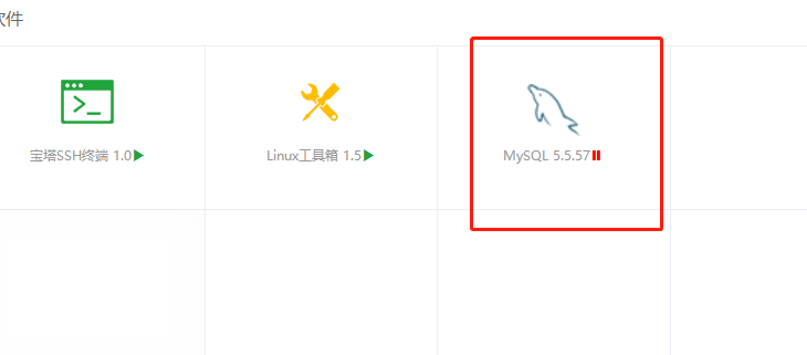

【已解决】mysql无法启动,急,一天了,强制重启服务器后
发表在 Linux面板2020-8-13 17:17 [复制链接] 5 1492

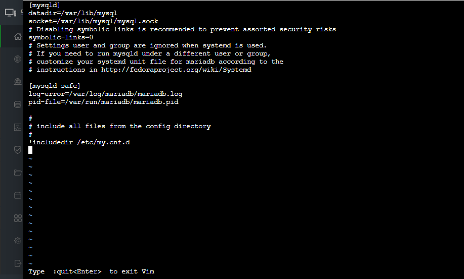

进入ssh 输入vi /etc/my.cnf 检查配置文件是否存在
[mysqld]
datadir=/var/lib/mysql
socket=/var/lib/mysql/mysql.sock
# Disabling symbolic-links is recommended to prevent assorted security risks
symbolic-links=0
# Settings user and group are ignored when systemd is used.
# If you need to run mysqld under a different user or group,
# customize your systemd unit file for mariadb according to the
# instructions in
[mysqld_safe]
log-error=/var/log/mariadb/mariadb.log
pid-file=/var/run/mariadb/mariadb.pid
# include all files from the config directory
!includedir /etc/my.cnf.d

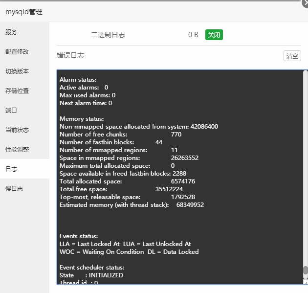

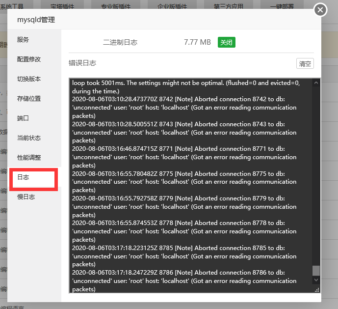

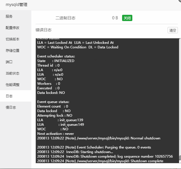

发表于 2020-8-13 17:38:59 | 显示全部楼层
您好,日志找一下error级别的截图看看
发表于 2020-8-13 17:54:43 | 显示全部楼层
错误日志内容很长
发表于 2020-8-13 18:25:02 | 显示全部楼层
默认my.cnf文件被覆盖了
请问你是什么系统 用的什么方式安装的mysql?是否有使用yum或dnf等命令?
手动清空一下这个文件 然后启动即可 宝塔会重新创建一份默认的my.cnf配置文件的
发表于 2020-8-14 10:34:28 | 显示全部楼层
已经解决了,谢谢
