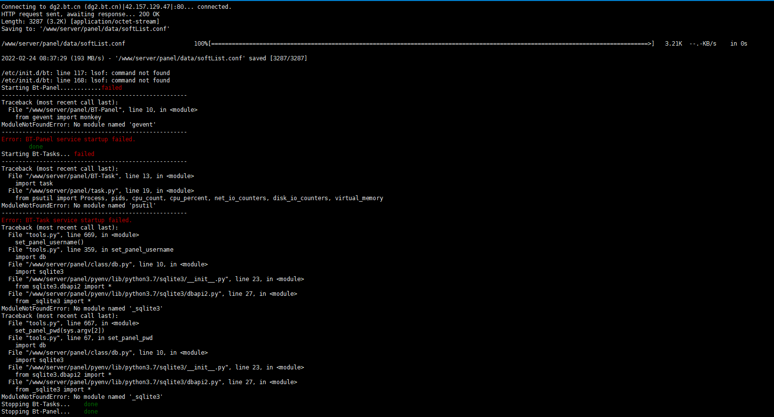

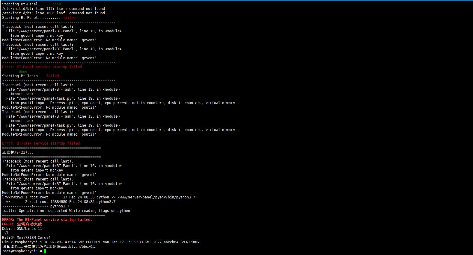

错误信息如下:

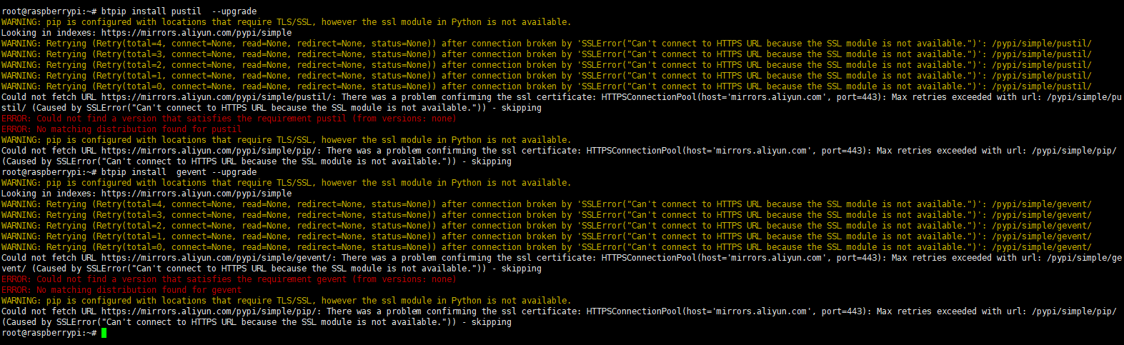

您好,您到服务器SSH终端里执行
  1. btpip install pustil  --upgrade
  2. btpip install  gevent --upgrade
发表于 2022-2-24 20:55:00 | 显示全部楼层
还是出错

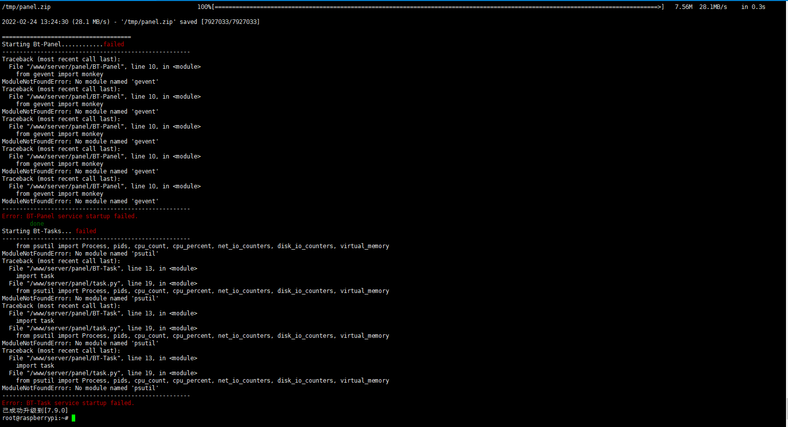

发表于 2022-2-24 21:04:29 | 显示全部楼层
  1. apt-get install openssl libssl-dev
  2. curl https://download.bt.cn/install/update_panel.sh|bash
发表于 2022-2-24 21:27:11 | 显示全部楼层
提示升级完成,但BT面板服务打不开,还是提示这个:WARNING: pip is configured with locations that require TLS/SSL, however the ssl module in Python is not available.

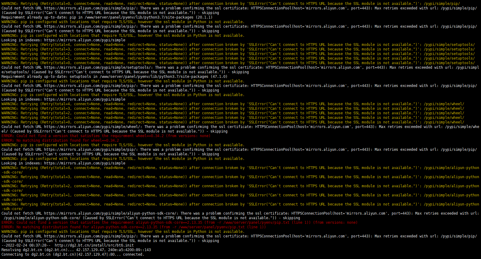

发表于 2022-2-24 21:30:46 | 显示全部楼层
snsiicom 发表于 2022-2-24 21:27
提示升级完成,但BT面板服务打不开,还是提示这个:WARNING: pip is configured with locations that ...
  1. apt-get --reinstall install openssl libssl-dev -y
试试?
发表于 2022-2-24 22:14:28 | 显示全部楼层
一样的,apt-get --reinstall install openssl libssl-dev -y这一步没有错误,但再升级安装,还是出错,运行不了。
应该是这个原因导致无法安装吧?WARNING: pip is configured with locations that require TLS/SSL, however the ssl module in Python is not available.
