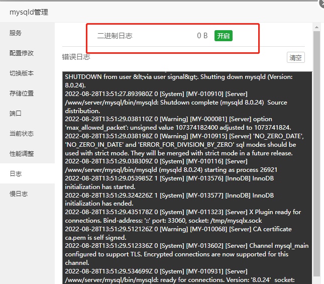

发表在 Linux面板2022-9-2 12:22 [复制链接] 16 14654
数据库配置:
[client]
#password = your_password
port  = 3306
socket  = /tmp/mysql.sock
[mysqld]
port  = 3306
datadir = /www/server/data
default_storage_engine = InnoDB
performance_schema_max_table_instances = 400
table_definition_cache = 400
skip-external-locking
key_buffer_size = 128M
max_allowed_packet = 100G
table_open_cache = 512
sort_buffer_size = 2M
net_buffer_length = 4K
read_buffer_size = 2M
read_rnd_buffer_size = 256K
myisam_sort_buffer_size = 32M
thread_cache_size = 64
tmp_table_size = 64M
default_authentication_plugin = mysql_native_password
lower_case_table_names = 1
sql-mode=NO_ENGINE_SUBSTITUTION,STRICT_TRANS_TABLES
explicit_defaults_for_timestamp = true
#skip-name-resolve
max_connections = 500
max_connect_errors = 100
open_files_limit = 65535
#log-bin=mysql-bin
#binlog_format=mixed
server-id = 1
binlog_expire_logs_seconds = 86400
slow_query_log=1
slow-query-log-file=/www/server/data/mysql-slow.log
long_query_time=3
#log_queries_not_using_indexes=on
early-plugin-load = ""
innodb_data_home_dir = /www/server/data
innodb_data_file_path = ibdata1:10M:autoextend
innodb_log_group_home_dir = /www/server/data
innodb_buffer_pool_size = 512M
innodb_log_file_size = 256M
innodb_log_buffer_size = 64M
innodb_flush_log_at_trx_commit = 1
innodb_lock_wait_timeout = 50
innodb_max_dirty_pages_pct = 90
innodb_read_io_threads = 2
innodb_write_io_threads = 2
[mysqldump]
quick
max_allowed_packet = 500M
[mysql]
no-auto-rehash
[myisamchk]
read_buffer = 2M
write_buffer = 2M
[mysqlhotcopy]
interactive-timeout

您好,登录到MySQL命令行执行下面命令看下MySQL的二进制开关是否为ON
  1. SHOW VARIABLES LIKE 'log_bin';

发表于 2022-9-2 15:15:18 | 显示全部楼层
log_bin  ON
这是没有有关吗?应该怎么关?
发表于 2022-9-2 15:25:26 | 显示全部楼层
宝塔用户_bcdhwc 发表于 2022-9-2 15:15
log_bin  ON
这是没有有关吗?应该怎么关?
您好,您那边在重启MySQL服务,然后再执行下面命令看下是不是为OFF了。

发表于 2022-9-2 16:31:57 | 显示全部楼层
已在MySQL的配置文件内的[mysqld]下添加了skip-log-bin参数,等用户观察然后反馈。
