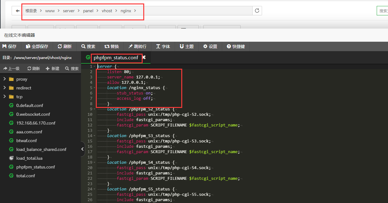

404是提示不存在,您那边到/www/server/panel/vhost/nginx这个路径下
查看下phpfpm_status.conf文件内容是否存在获取Nginx负载的内容。如果不存在则添加下面内容重新访问打开
  1. listen 80;
  2.         server_name 127.0.0.1;
  3.         allow 127.0.0.1;
  4.         location /nginx_status {
  5.                 stub_status on;
  6.                 access_log off;
  7.         }

你好,这个路径/www/server/panel/vhost/nginx
的文件存在的,里面的东西也在。。。。一模一样的。。。
上传不了图片,我复制过来:
server {
    listen 80;
    allow 127.0.0.1;
        stub_status on;
        access_log off;
    location /phpfpm_52_status {
        fastcgi_pass unix:/tmp/php-cgi-52.sock;
        include fastcgi_params;
        fastcgi_param SCRIPT_FILENAME $fastcgi_script_name;
    location /phpfpm_53_status {
        fastcgi_pass unix:/tmp/php-cgi-53.sock;
    location /phpfpm_54_status {
        fastcgi_pass unix:/tmp/php-cgi-54.sock;
    location /phpfpm_55_status {
        fastcgi_pass unix:/tmp/php-cgi-55.sock;
    location /phpfpm_56_status {
        fastcgi_pass unix:/tmp/php-cgi-56.sock;
    location /phpfpm_70_status {
        fastcgi_pass unix:/tmp/php-cgi-70.sock;
    location /phpfpm_71_status {
        fastcgi_pass unix:/tmp/php-cgi-71.sock;
    location /phpfpm_72_status {
        fastcgi_pass unix:/tmp/php-cgi-72.sock;
    location /phpfpm_73_status {
        fastcgi_pass unix:/tmp/php-cgi-73.sock;
    location /phpfpm_74_status {
        fastcgi_pass unix:/tmp/php-cgi-74.sock;
    location /phpfpm_75_status {
        fastcgi_pass unix:/tmp/php-cgi-75.sock;
    location /phpfpm_80_status {
        fastcgi_pass unix:/tmp/php-cgi-80.sock;
    location /phpfpm_81_status {
        fastcgi_pass unix:/tmp/php-cgi-81.sock;

遇到楼上一样的问题,这个原因是127.0.0.1 这个IP被占用了。建议官方更换其他IP,因为127.0.0.1这个太常用了
发表于 2024-10-22 11:59:44 | 显示全部楼层
遇到了同样的问题,此配置文件phpfpm_status.conf使用的127.0.0.1:80,自行配置的网站中也存在此配置,导致冲突
