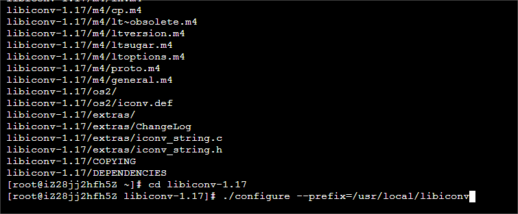

发表于 2022-12-5 14:26:08 | 显示全部楼层
谢花郎 发表于 2022-12-5 12:10
安装过程截图发下看看
libiconv-1.17/libcharset/m4/codeset.m4
libiconv-1.17/libcharset/m4/visibility.m4
libiconv-1.17/libcharset/DEPENDENCIES
libiconv-1.17/config.h.in
libiconv-1.17/m4/
libiconv-1.17/m4/eilseq.m4
libiconv-1.17/m4/libtool.m4
libiconv-1.17/m4/ln.m4
libiconv-1.17/m4/cp.m4
libiconv-1.17/m4/lt~obsolete.m4
libiconv-1.17/m4/ltversion.m4
libiconv-1.17/m4/ltsugar.m4
libiconv-1.17/m4/ltoptions.m4
libiconv-1.17/m4/proto.m4
libiconv-1.17/m4/general.m4
libiconv-1.17/os2/
libiconv-1.17/os2/iconv.def
libiconv-1.17/extras/
libiconv-1.17/extras/ChangeLog
libiconv-1.17/extras/iconv_string.c
libiconv-1.17/extras/iconv_string.h
libiconv-1.17/COPYING
libiconv-1.17/DEPENDENCIES
[root@iZ28jj2hfh5Z ~]# cd libiconv-1.17
[root@iZ28jj2hfh5Z libiconv-1.17]# ./configure --prefix=/usr/local/libiconv
发表于 2022-12-5 14:31:10 | 显示全部楼层
libiconv-1.17/lib ...
这个./configure --prefix=/usr/local/libiconv执行后的截图提供下
