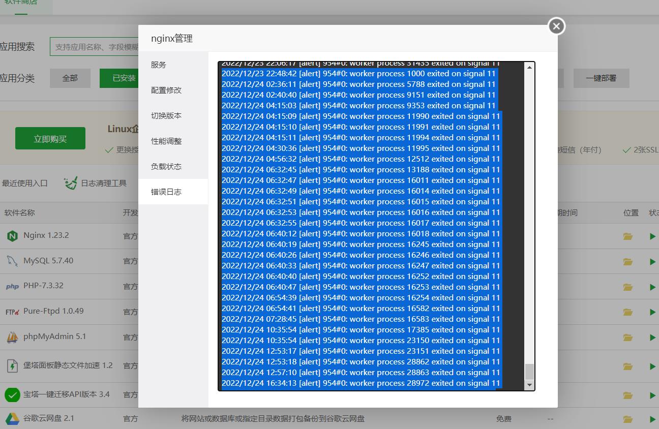

【待反馈】ng一直有这个错误日志怎么解决 worker process 16014 e.
发表在 Linux面板2022-12-24 17:51 [复制链接] 3 4787
2022/12/24 06:32:49 [alert] 954#0: worker process 16014 exited on signal 11
2022/12/24 06:32:51 [alert] 954#0: worker process 16015 exited on signal 11
2022/12/24 06:32:53 [alert] 954#0: worker process 16016 exited on signal 11
2022/12/24 06:32:55 [alert] 954#0: worker process 16017 exited on signal 11
2022/12/24 06:40:12 [alert] 954#0: worker process 16018 exited on signal 11
2022/12/24 06:40:19 [alert] 954#0: worker process 16245 exited on signal 11
2022/12/24 06:40:26 [alert] 954#0: worker process 16246 exited on signal 11
2022/12/24 06:40:33 [alert] 954#0: worker process 16247 exited on signal 11
2022/12/24 06:40:40 [alert] 954#0: worker process 16252 exited on signal 11
2022/12/24 06:40:47 [alert] 954#0: worker process 16253 exited on signal 11
2022/12/24 06:54:39 [alert] 954#0: worker process 16254 exited on signal 11
2022/12/24 06:54:41 [alert] 954#0: worker process 16582 exited on signal 11
2022/12/24 07:28:45 [alert] 954#0: worker process 16583 exited on signal 11
2022/12/24 10:35:54 [alert] 954#0: worker process 17385 exited on signal 11
2022/12/24 10:35:54 [alert] 954#0: worker process 23150 exited on signal 11
2022/12/24 12:53:17 [alert] 954#0: worker process 23151 exited on signal 11
2022/12/24 12:53:18 [alert] 954#0: worker process 28862 exited on signal 11
2022/12/24 12:57:10 [alert] 954#0: worker process 28863 exited on signal 11
2022/12/24 16:34:13 [alert] 954#0: worker process 28972 exited on signal 11
2022/12/24 16:34:15 [alert] 954#0: worker process 2710 exited on signal 11

您好,尝试重启nginx看看

这是网上查到的资料,但是我不会改
1)worker process 某某某 exited on signal 11 (core dumped)
这种错误基本就是刷error.log的屏,严重的甚至直接让nginx崩掉。具体表现在用户端就是“视频打不开,网页打不开等等等”。
这种错误一般是表示用户程序nginx进行读操作时访问的地址无效,具体一点就是搜索引擎的蜘蛛在爬取到加密部分时,得不到正确的路径,又没有被定位到错误页导致的。
如何修改,在nginx.conf里的防盗链部分检查一下“secure_download_fail_location;” ,即“请求错误时,定向到错误页”的模块,确认location是否定向到一个正确地址为错误页面。

您好,执行命令查看下是否被系统关闭了?
  1. dmesg|grep -E "kill|nginx|oom"
