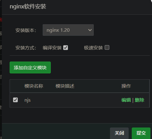

【疑难】宝塔面板Nginx编译安装njs模块失败
发表在 Linux面板2022-12-28 14:40 [复制链接] 9 11273
njs官网执行如下指令下载
hg clone http://hg.nginx.org/njs模块配置如下图,
报错信息如下图

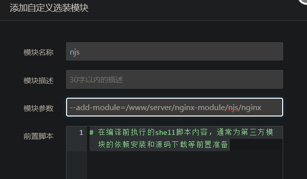

发表于 2022-12-28 14:46:30 | 显示全部楼层
您好,截图中没有前置参数是否需要添加?
发表于 2022-12-28 14:54:20 | 显示全部楼层
运维风光 发表于 2022-12-28 14:46
您好,截图中没有前置参数是否需要添加?
您好 模块参数如下
发表于 2022-12-28 15:19:41 | 显示全部楼层
ALiesZ 发表于 2022-12-28 14:54
您好 模块参数如下
前置脚本是否需要添加?
发表于 2022-12-28 15:25:35 | 显示全部楼层
运维风光 发表于 2022-12-28 15:19
前置脚本是否需要添加?
前置脚本应该不需要添加
即使添加如下指令
hg clone http://hg.nginx.org/njs /www/server/nginx-module/njs/
也仍旧会报相同错误

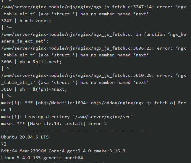

您好 我又分别尝试了在在install.sh中添加编译参数 和在宝塔编译安装nginx后进入nginx目录修改编译参数手动编译,在使用make指令编译后,会出现和上面相同的错误提示,报错如下
/www/server/nginx-module/njs/nginx/ngx_js_fetch.c:2286:23: error: ‘ngx_table_elt_t’ {aka ‘struct <anonymous>’} has no member named ‘next’
2286 |             ph = &h.next;
/www/server/nginx-module/njs/nginx/ngx_js_fetch.c:2287:38: error: ‘ngx_table_elt_t’ {aka ‘struct <anonymous>’} has no member named ‘next’
2287 |             while (*ph) { ph = &(*ph)->next; }
/www/server/nginx-module/njs/nginx/ngx_js_fetch.c:2307:6: error: ‘ngx_table_elt_t’ {aka ‘struct <anonymous>’} has no member named ‘next’
2307 |     h->next = NULL;
/www/server/nginx-module/njs/nginx/ngx_js_fetch.c: In function ‘ngx_headers_js_get’:
/www/server/nginx-module/njs/nginx/ngx_js_fetch.c:3210:20: error: ‘ngx_table_elt_t’ {aka ‘struct <anonymous>’} has no member named ‘next’
3210 |             ph = ph->next;
/www/server/nginx-module/njs/nginx/ngx_js_fetch.c:3226:16: error: ‘ngx_table_elt_t’ {aka ‘struct <anonymous>’} has no member named ‘next’
3226 |         ph = ph->next;
/www/server/nginx-module/njs/nginx/ngx_js_fetch.c:3242:14: error: ‘ngx_table_elt_t’ {aka ‘struct <anonymous>’} has no member named ‘next’
3242 |         if (h->next == NULL) {
/www/server/nginx-module/njs/nginx/ngx_js_fetch.c:3247:14: error: ‘ngx_table_elt_t’ {aka ‘struct <anonymous>’} has no member named ‘next’
3247 |         h = h->next;
/www/server/nginx-module/njs/nginx/ngx_js_fetch.c: In function ‘ngx_headers_js_ext_set’:
/www/server/nginx-module/njs/nginx/ngx_js_fetch.c:3606:23: error: ‘ngx_table_elt_t’ {aka ‘struct <anonymous>’} has no member named ‘next’
3606 |             ph = &h.next;
/www/server/nginx-module/njs/nginx/ngx_js_fetch.c:3610:28: error: ‘ngx_table_elt_t’ {aka ‘struct <anonymous>’} has no member named ‘next’
3610 |                 ph = &(*ph)->next;
make[1]: *** [objs/Makefile:1717: objs/addon/nginx/ngx_js_fetch.o] Error 1
make[1]: Leaving directory '/www/server/nginx/src'
make: *** [Makefile:10: build] Error 2
请问出现这种情况的原因可能是什么,有什么其他方法解决么
