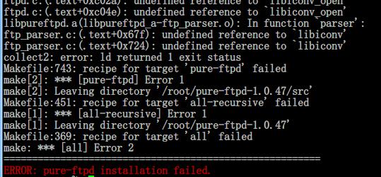

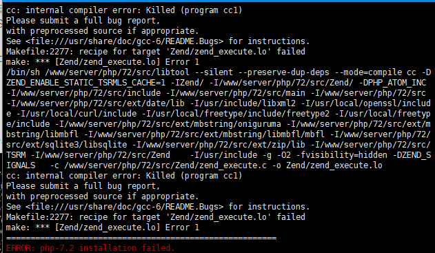

如果有人有软件装不上
你可以进入ssh 输入这条命令
  1. cat /tmp/panelExec.log
将以下报错信息截图发上来,好分析大部分是基于什么原因装不上的

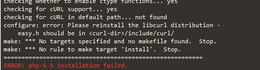

发表于 2018-2-5 17:10:48 | 显示全部楼层
Ubuntu 16.04 64位 LTS
PHP7.1:
checking whether to enable bc style precision math functions... yes
checking for BZip2 support... no
checking whether to enable calendar conversion support... no
checking whether to enable ctype functions... yes
checking for cURL support... yes
checking for cURL in default path... not found
checking for cURL in multiarch path... not found
./configure: line 23539: curl-dir: No such file or directory
checking for cURL 7.10.5 or greater... ./configure: line 23554: curl-config: command not found
configure: error: cURL version 7.10.5 or later is required to compile php with cURL support
make: *** 没有指明目标并且找不到 makefile。 停止。
make: *** No rule to make target 'install'。 停止。
ERROR: php-7.1 installation failed.

发表于 2018-2-7 10:43:14 | 显示全部楼层
Debian8 x64
checking for xml2-config path... /usr/bin/xml2-config
checking whether libxml build works... yes
checking for OpenSSL support... yes
checking for Kerberos support... no
checking for DSA_get_default_method in -lssl... no
checking for X509_free in -lcrypto... yes
checking for pkg-config... no
checking for OpenSSL version... >= 0.9.6
checking for CRYPTO_free in -lcrypto... yes
checking for SSL_CTX_set_ssl_version in -lssl... yes
checking for PCRE library to use... bundled
checking whether to enable the SQLite3 extension... yes
checking bundled sqlite3 library... yes
checking for ZLIB support... yes
checking if the location of ZLIB install directory is defined... no
checking for zlib version >= 1.2.0.4... 1.2.8
checking for gzgets in -lz... yes
checking if we should use cURL for url streams... no
configure: error: Please reinstall the libcurl distribution -
    easy.h should be in <curl-dir>/include/curl/
make: *** No targets specified and no makefile found.  Stop.
make: *** No rule to make target 'install'.  Stop.
ERROR: php-5.4 installation failed.
发表于 2018-2-7 16:58:29 | 显示全部楼层
Debian 8.10 x64
参考5楼指点,综合Google结果,用如下命令解决了用面板php跟mysql装不上的问题,大致问题就是依赖包安装的不全
apt-get install cmake libncurses5-dev libssl-dev libcurl4-openssl-dev pkg-config libicu-dev libfreetype6-dev
发表于 2018-2-7 17:20:38 | 显示全部楼层
valianliu 发表于 2018-2-7 16:58
Debian 8.10 x64
参考5楼指点,综合Google结果,用如下命令解决了用面板php跟mysql装不上的问题,大致问题 ...
之前改了一个地方导致debian/ubuntu的依赖安装脚本是centos的,导致大量依赖没安装,现已修复

checking whether getgroups 0 is sane... no
checking whether realpath likes unreadable directories... yes
checking whether you already have a standard MD5 implementation... no
checking whether you already have a standard SHA1 implementation... no
checking whether we are inside a Virtuozzo virtual host... no
checking default TCP send buffer size... 16384
checking default TCP receive buffer size... 87380
checking for DH_new in -lcrypto... yes
checking for SSL_accept in -lssl... yes
checking for DH_get_2048_256... yes
checking for iconv_open in -liconv... no
checking for libiconv_open in -liconv... no
configure: You have /dev/urandom - Great
configure: You have /dev/random - Great
checking that generated files are newer than configure... done
configure: creating ./config.status
config.status: creating Makefile
config.status: creating src/Makefile
config.status: creating pam/Makefile
config.status: creating man/Makefile
config.status: creating gui/Makefile
config.status: creating m4/Makefile
config.status: creating pure-ftpd.conf
config.status: creating puredb/Makefile
config.status: creating puredb/src/Makefile
config.status: creating man/pure-ftpd.8
config.status: creating man/pure-ftpwho.8
config.status: creating man/pure-mrtginfo.8
config.status: creating man/pure-uploadscript.8
config.status: creating man/pure-statsdecode.8
config.status: creating man/pure-quotacheck.8
config.status: creating man/pure-pw.8
config.status: creating man/pure-pwconvert.8
config.status: creating man/pure-authd.8
config.status: creating config.h
config.status: config.h is unchanged
config.status: executing depfiles commands
configure: +--------------------------------------------------------+
configure: | You can subscribe to the Pure-FTPd users mailing-list  |
configure: | to ask for help and to stay informed of new releases.  |
configure: | Go to http://www.pureftpd.org/ml/ now!                 |
make  all-recursive
make[1]: Entering directory '/root/pure-ftpd-1.0.47'
Making all in puredb
make[2]: Entering directory '/root/pure-ftpd-1.0.47/puredb'
Making all in src
make[3]: Entering directory '/root/pure-ftpd-1.0.47/puredb/src'
make[3]: Nothing to be done for 'all'.
make[3]: Leaving directory '/root/pure-ftpd-1.0.47/puredb/src'
make[3]: Entering directory '/root/pure-ftpd-1.0.47/puredb'
make[3]: Nothing to be done for 'all-am'.
make[3]: Leaving directory '/root/pure-ftpd-1.0.47/puredb'
make[2]: Leaving directory '/root/pure-ftpd-1.0.47/puredb'
Making all in src
make[2]: Entering directory '/root/pure-ftpd-1.0.47/src'
gcc  -O2 -fPIC -fPIE -fwrapv -fno-strict-aliasing -fno-strict-overflow -fstack-protector-all -Winit-self -Wwrite-strings -Wdiv-by-zero  -pie -Wl,-z,relro -Wl,-z,now -Wl,-z,noexecstack -L/usr/local/lib -o pure-ftpd main.o libpureftpd.a ../puredb/src/libpuredb_read.a  -lssl -lcrypto -lcrypt -lcap
libpureftpd.a(libpureftpd_a-ftpd.o): In function `charset_fs2client':
ftpd.c.text+0x1b93): undefined reference to `libiconv'
ftpd.c.text+0x1bdc): undefined reference to `libiconv'
libpureftpd.a(libpureftpd_a-ftpd.o): In function `pureftpd_start':
ftpd.c.text+0xbdeb): undefined reference to `libiconv_close'
ftpd.c.text+0xbdfd): undefined reference to `libiconv_close'
ftpd.c.text+0xbe0f): undefined reference to `libiconv_close'
ftpd.c.text+0xbe21): undefined reference to `libiconv_close'
ftpd.c.text+0xbfbd): undefined reference to `libiconv_open'
ftpd.c.text+0xbfe1): undefined reference to `libiconv_open'
ftpd.c.text+0xc02a): undefined reference to `libiconv_open'
ftpd.c.text+0xc04e): undefined reference to `libiconv_open'
libpureftpd.a(libpureftpd_a-ftp_parser.o): In function `parser':
ftp_parser.c:(.text+0x67f): undefined reference to `libiconv'
ftp_parser.c:(.text+0x724): undefined reference to `libiconv'
collect2: error: ld returned 1 exit status
Makefile:743: recipe for target 'pure-ftpd' failed
make[2]: *** [pure-ftpd] Error 1
make[2]: Leaving directory '/root/pure-ftpd-1.0.47/src'
Makefile:451: recipe for target 'all-recursive' failed
make[1]: *** [all-recursive] Error 1
make[1]: Leaving directory '/root/pure-ftpd-1.0.47'
Makefile:369: recipe for target 'all' failed
make: *** [all] Error 2
已经升级到最新版本也已执行apt-get install cmake libncurses5-dev libssl-dev libcurl4-openssl-dev pkg-config libicu-dev libfreetype6-dev
但是安装apache Pure-Ftpd php时报错,但是安装mysql没事...

Debian 9.0 X64
cc: internal compiler error: Killed (program cc1)
Please submit a full bug report,
with preprocessed source if appropriate.
See <file:///usr/share/doc/gcc-6/README.Bugs> for instructions.
Makefile:2277: recipe for target 'Zend/zend_execute.lo' failed
make: *** [Zend/zend_execute.lo] Error 1
/bin/sh /www/server/php/72/src/libtool --silent --preserve-dup-deps --mode=compile cc -DZEND_ENABLE_STATIC_TSRMLS_CACHE=1 -IZend/ -I/www/server/php/72/src/Zend/ -DPHP_ATOM_INC -I/www/server/php/72/src/include -I/www/server/php/72/src/main -I/www/server/php/72/src -I/www/server/php/72/src/ext/date/lib -I/usr/include/libxml2 -I/usr/local/openssl/include -I/usr/local/curl/include -I/usr/local/freetype/include/freetype2 -I/usr/local/freetype/include -I/www/server/php/72/src/ext/mbstring/oniguruma -I/www/server/php/72/src/ext/mbstring/libmbfl -I/www/server/php/72/src/ext/mbstring/libmbfl/mbfl -I/www/server/php/72/src/ext/sqlite3/libsqlite -I/www/server/php/72/src/ext/zip/lib -I/www/server/php/72/src/TSRM -I/www/server/php/72/src/Zend    -I/usr/include -g -O2 -fvisibility=hidden -DZEND_SIGNALS   -c /www/server/php/72/src/Zend/zend_execute.c -o Zend/zend_execute.lo
ERROR: php-7.2 installation failed.
发表于 2018-3-16 09:38:13 | 显示全部楼层
ijevin 发表于 2018-3-15 22:40
Debian 9.0 X64
你内存多大 512MB内存?
看起来是编译的时候内存不足导致被杀掉进程了
