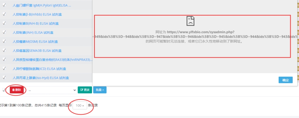

后台删除内容的时候,如果每页显示条数在100条,200条的时候,点击确定删除按钮会弹出错误,然后网站就打不开了,要过几分钟才可以打开。但100条以内不会,如图:

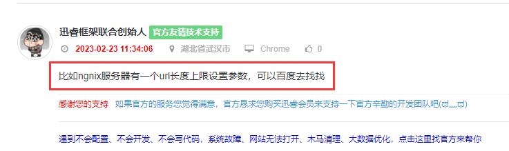

官方给我的建议是修改nginx  url长度限制,请问怎么修改呢?谢谢

网址为 https://www.ylfxbio.com/sysadmin.php?s=product&c=home&m=del&is_iframe=1&is_form=1&is_admin=1&is_tips=&csrf_test_name=dc341d99f78745996fc6d0a4431aa518&btSelectAll=on&ids%5B%5D=6241&ids%5B%5D=6240&ids%5B%5D=6239&ids%5B%5D=6238&ids%5B%5D=6237&ids%5B%5D=6236&ids%5B%5D=6235&ids%5B%5D=6234&ids%5B%5D=6233&ids%5B%5D=6232&ids%5B%5D=6231&ids%5B%5D=6230&ids%5B%5D=6229&ids%5B%5D=6228&ids%5B%5D=6227&ids%5B%5D=6226&ids%5B%5D=6225&ids%5B%5D=6224&ids%5B%5D=6223&ids%5B%5D=6222&ids%5B%5D=6221&ids%5B%5D=6220&ids%5B%5D=6219&ids%5B%5D=6218&ids%5B%5D=6217&ids%5B%5D=6216&ids%5B%5D=6215&ids%5B%5D=6214&ids%5B%5D=6213&ids%5B%5D=6212&ids%5B%5D=6211&ids%5B%5D=6210&ids%5B%5D=6209&ids%5B%5D=6208&ids%5B%5D=6207&ids%5B%5D=6206&ids%5B%5D=6205&ids%5B%5D=6204&ids%5B%5D=6203&ids%5B%5D=6202&ids%5B%5D=6201&ids%5B%5D=6200&ids%5B%5D=6199&ids%5B%5D=6198&ids%5B%5D=6197&ids%5B%5D=6196&ids%5B%5D=6195&ids%5B%5D=6194&ids%5B%5D=6193&ids%5B%5D=6192&ids%5B%5D=6191&ids%5B%5D=6190&ids%5B%5D=6189&ids%5B%5D=6188&ids%5B%5D=6187&ids%5B%5D=6186&ids%5B%5D=6185&ids%5B%5D=6184&ids%5B%5D=6183&ids%5B%5D=6182&ids%5B%5D=6181&ids%5B%5D=6180&ids%5B%5D=6179&ids%5B%5D=6178&ids%5B%5D=6177&ids%5B%5D=6176&ids%5B%5D=6175&ids%5B%5D=6174&ids%5B%5D=6173&ids%5B%5D=6172&ids%5B%5D=6171&ids%5B%5D=6170&ids%5B%5D=6169&ids%5B%5D=6168&ids%5B%5D=6167&ids%5B%5D=6166&ids%5B%5D=6165&ids%5B%5D=6164&ids%5B%5D=6163&ids%5B%5D=6162&ids%5B%5D=6161&ids%5B%5D=6160&ids%5B%5D=6159&ids%5B%5D=6158&ids%5B%5D=6157&ids%5B%5D=6156&ids%5B%5D=6155&ids%5B%5D=6154&ids%5B%5D=6153&ids%5B%5D=6152&ids%5B%5D=6151&ids%5B%5D=6150&ids%5B%5D=6149&ids%5B%5D=6148&ids%5B%5D=6147&ids%5B%5D=6146&ids%5B%5D=6145&ids%5B%5D=6144&ids%5B%5D=6143&ids%5B%5D=6142&catid=0 的网页可能暂时无法连接,或者它已永久性地移动到了新网址。

理想天空 发表于 2023-2-23 16:18
网址为 https://www.ylfxbio.com/sysadmin.php?s=product&c=home&m=del&is_iframe=1&is_form=1&is_admin= ...
上面这个是网站弹出的错误

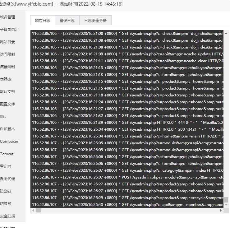

发表于 2023-2-23 16:30:31 | 显示全部楼层
理想天空 发表于 2023-2-23 16:30
没有日志,只有网站日志
QQ截图20230223162932.jpg 网站的
发表于 2023-2-23 16:33:00 | 显示全部楼层
看它的错误日志
发表于 2023-2-23 16:36:26 | 显示全部楼层
116.52.86.106 - - [23/Feb/2023:16:21:32 +0800] "GET /sysadmin.php?s=product&c=home&m=del&is_iframe=1&is_form=1&is_admin=1&is_tips=&csrf_test_name=dc341d99f78745996fc6d0a4431aa518&btSelectAll=on&ids%5B%5D=6241&ids%5B%5D=6240&ids%5B%5D=6239&ids%5B%5D=6238&ids%5B%5D=6237&ids%5B%5D=6236&ids%5B%5D=6235&ids%5B%5D=6234&ids%5B%5D=6233&ids%5B%5D=6232&ids%5B%5D=6231&ids%5B%5D=6230&ids%5B%5D=6229&ids%5B%5D=6228&ids%5B%5D=6227&ids%5B%5D=6226&ids%5B%5D=6225&ids%5B%5D=6224&ids%5B%5D=6223&ids%5B%5D=6222&ids%5B%5D=6221&ids%5B%5D=6220&ids%5B%5D=6219&ids%5B%5D=6218&ids%5B%5D=6217&ids%5B%5D=6216&ids%5B%5D=6215&ids%5B%5D=6214&ids%5B%5D=6213&ids%5B%5D=6212&ids%5B%5D=6211&ids%5B%5D=6210&ids%5B%5D=6209&ids%5B%5D=6208&ids%5B%5D=6207&ids%5B%5D=6206&ids%5B%5D=6205&ids%5B%5D=6204&ids%5B%5D=6203&ids%5B%5D=6202&ids%5B%5D=6201&ids%5B%5D=6200&ids%5B%5D=6199&ids%5B%5D=6198&ids%5B%5D=6197&ids%5B%5D=6196&ids%5B%5D=6195&ids%5B%5D=6194&ids%5B%5D=6193&ids%5B%5D=6192&ids%5B%5D=6191&ids%5B%5D=6190&ids%5B%5D=6189&ids%5B%5D=6188&ids%5B%5D=6187&ids%5B%5D=6186&ids%5B%5D=6185&ids%5B%5D=6184&ids%5B%5D=6183&ids%5B%5D=6182&ids%5B%5D=6181&ids%5B%5D=6180&ids%5B%5D=6179&ids%5B%5D=6178&ids%5B%5D=6177&ids%5B%5D=6176&ids%5B%5D=6175&ids%5B%5D=6174&ids%5B%5D=6173&ids%5B%5D=6172&ids%5B%5D=6171&ids%5B%5D=6170&ids%5B%5D=6169&ids%5B%5D=6168&ids%5B%5D=6167&ids%5B%5D=6166&ids%5B%5D=6165&ids%5B%5D=6164&ids%5B%5D=6163&ids%5B%5D=6162&ids%5B%5D=6161&ids%5B%5D=6160&ids%5B%5D=6159&ids%5B%5D=6158&ids%5B%5D=6157&ids%5B%5D=6156&ids%5B%5D=6155&ids%5B%5D=6154&ids%5B%5D=6153&ids%5B%5D=6152&ids%5B%5D=6151&ids%5B%5D=6150&ids%5B%5D=6149&ids%5B%5D=6148&ids%5B%5D=6147&ids%5B%5D=6146&ids%5B%5D=6145&ids%5B%5D=6144&ids%5B%5D=6143&ids%5B%5D=6142&catid=0 HTTP/2.0" 444 0 "https://www.ylfxbio.com/sysadmin.php?s=product&c=home&m=index" "Mozilla/5.0 (Windows NT 10.0; WOW64) AppleWebKit/537.36 (KHTML, like Gecko) Chrome/86.0.4240.198 Safari/537.36"
116.52.86.106 - - [23/Feb/2023:16:21:39 +0800] "GET /sysadmin.php HTTP/2.0" 444 0 "-" "Mozilla/5.0 (Windows NT 10.0; WOW64) AppleWebKit/537.36 (KHTML, like Gecko) Chrome/86.0.4240.198 Safari/537.36"
