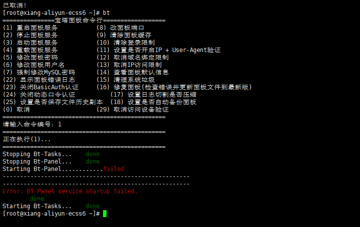

反正结果就是,现在已经启动不了宝塔面板了。服务器ssh能连上,然后输入bt,再用16修复了,还是不管用。 Snipaste_2023-04-05_20-38-48.png 启动不了,然后我之前用宝塔面板搭建的网站,那些网站也打不开。这种情况咋办,咋备份。我现在只想把一个WordPress网站备份出来,其他要不要都不重要了。
然后这个阿里的云服务器也反正快到期了,我也不准备续费。所以我想把数据搞出来,然后换个服务器(这次再也不选CentOS了),重新装宝塔面板。

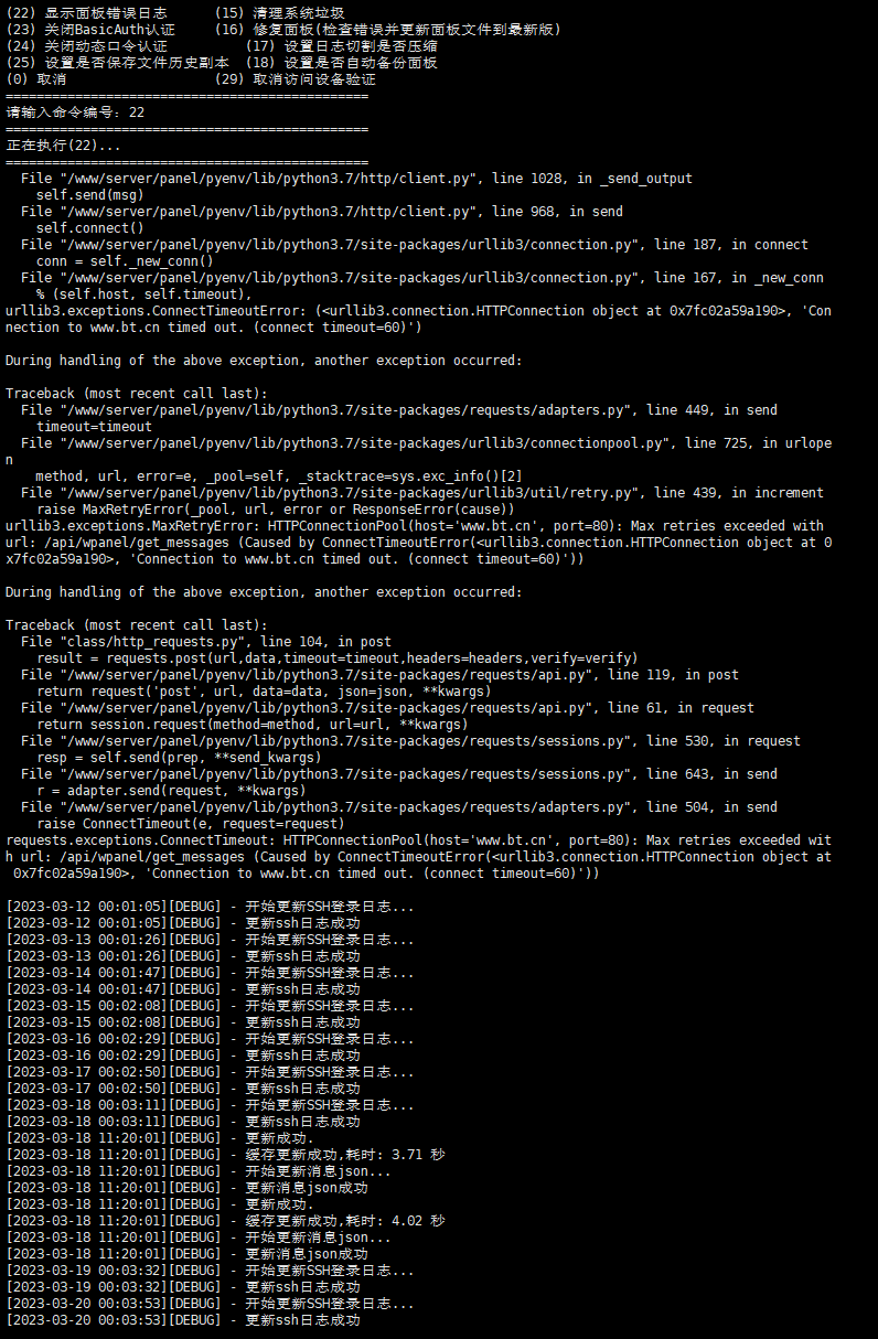

您好,麻烦您那边执行bt 22命令看看具体的面板运行日志,具体需要根据当前的一些报错排查定位问题。

老师,帮忙看看这样要怎么搞
  1. 请输入命令编号:22
  2. ===============================================
  3. 正在执行(22)...
  4. ===============================================
  5.   File "/www/server/panel/pyenv/lib/python3.7/http/client.py", line 1028, in _send_output
  6.     self.send(msg)
  7.   File "/www/server/panel/pyenv/lib/python3.7/http/client.py", line 968, in send
  8.     self.connect()
  9.   File "/www/server/panel/pyenv/lib/python3.7/site-packages/urllib3/connection.py", line 187, in connect
  10.     conn = self._new_conn()
  11.   File "/www/server/panel/pyenv/lib/python3.7/site-packages/urllib3/connection.py", line 167, in _new_conn
  12.     % (self.host, self.timeout),
  13. urllib3.exceptions.ConnectTimeoutError: (<urllib3.connection.HTTPConnection object at 0x7fc02a59a190>, 'Connection to www.bt.cn timed out. (connect timeout=60)')
  14. During handling of the above exception, another exception occurred:
  15. Traceback (most recent call last):
  16.   File "/www/server/panel/pyenv/lib/python3.7/site-packages/requests/adapters.py", line 449, in send
  17.     timeout=timeout
  18.   File "/www/server/panel/pyenv/lib/python3.7/site-packages/urllib3/connectionpool.py", line 725, in urlopen
  19.     method, url, error=e, _pool=self, _stacktrace=sys.exc_info()[2]
  20.   File "/www/server/panel/pyenv/lib/python3.7/site-packages/urllib3/util/retry.py", line 439, in increment
  21.     raise MaxRetryError(_pool, url, error or ResponseError(cause))
  22. urllib3.exceptions.MaxRetryError: HTTPConnectionPool(host='www.bt.cn', port=80): Max retries exceeded with url: /api/wpanel/get_messages (Caused by ConnectTimeoutError(<urllib3.connection.HTTPConnection object at 0x7fc02a59a190>, 'Connection to www.bt.cn timed out. (connect timeout=60)'))
  23. During handling of the above exception, another exception occurred:
  24. Traceback (most recent call last):
  25.   File "class/http_requests.py", line 104, in post
  26.     result = requests.post(url,data,timeout=timeout,headers=headers,verify=verify)
  27.   File "/www/server/panel/pyenv/lib/python3.7/site-packages/requests/api.py", line 119, in post
  28.     return request('post', url, data=data, json=json, **kwargs)
  29.   File "/www/server/panel/pyenv/lib/python3.7/site-packages/requests/api.py", line 61, in request
  30.     return session.request(method=method, url=url, **kwargs)
  31.   File "/www/server/panel/pyenv/lib/python3.7/site-packages/requests/sessions.py", line 530, in request
  32.     resp = self.send(prep, **send_kwargs)
  33.   File "/www/server/panel/pyenv/lib/python3.7/site-packages/requests/sessions.py", line 643, in send
  34.     r = adapter.send(request, **kwargs)
  35.   File "/www/server/panel/pyenv/lib/python3.7/site-packages/requests/adapters.py", line 504, in send
  36.     raise ConnectTimeout(e, request=request)
  37. requests.exceptions.ConnectTimeout: HTTPConnectionPool(host='www.bt.cn', port=80): Max retries exceeded with url: /api/wpanel/get_messages (Caused by ConnectTimeoutError(<urllib3.connection.HTTPConnection object at 0x7fc02a59a190>, 'Connection to www.bt.cn timed out. (connect timeout=60)'))
  38. [2023-03-12 00:01:05][DEBUG] - 开始更新SSH登录日志...
  39. [2023-03-12 00:01:05][DEBUG] - 更新ssh日志成功
