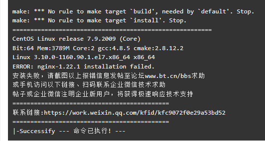

面板、插件版本:Linux免费版
系统版本:8.0.1
问题描述:ning安装报错
make: *** No rule to make target `build', needed by `default'. Stop.make: *** No rule to make target `install'. Stop.

您好,麻烦您提供完整的执行日志,以便分析安装引起失败问题
发表于 2023-7-21 13:32:42 | 显示全部楼层

checking for zlib library ... not found
./configure: error: the HTTP gzip module requires the zlib library.
You can either disable the module by using --without-http_gzip_module
option, or install the zlib library into the system, or build the zlib library
statically from the source with nginx by using --with-zlib= option.

您在服务器命令行下执行下面命令安装下这个zlib-devel组件然后重新安装看看
  1. yum install zlib-devel

Error:  Multilib version problems found. This often means that the root
       cause is something else and multilib version checking is just
       pointing out that there is a problem. Eg.:

尝试执行下面命令,然后再去安装zlib-devel组件
yum install --setopt=protected_multilib=false zlib-devel
安装命令
