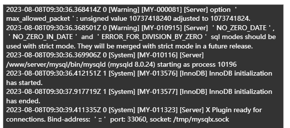

问题描述:在重启 Mysql 时,一直启动失败,无法启动
2023-08-08T09:30:36.368414Z 0 [Warning] [MY-000081] [Server] option 'max_allowed_packet': unsigned value 10737418240 adjusted to 1073741824.
2023-08-08T09:30:36.368501Z 0 [Warning] [MY-010915] [Server] 'NO_ZERO_DATE', 'NO_ZERO_IN_DATE' and 'ERROR_FOR_DIVISION_BY_ZERO' sql modes should be used with strict mode. They will be merged with strict mode in a future release.
2023-08-08T09:30:36.369906Z 0 [System] [MY-010116] [Server] /www/server/mysql/bin/mysqld (mysqld 8.0.24) starting as process 10196
2023-08-08T09:30:36.412151Z 1 [System] [MY-013576] [InnoDB] InnoDB initialization has started.
2023-08-08T09:30:37.917719Z 1 [System] [MY-013577] [InnoDB] InnoDB initialization has ended.
2023-08-08T09:30:39.411335Z 0 [System] [MY-011323] [Server] X Plugin ready for connections. Bind-address: '::' port: 33060, socket: /tmp/mysqlx.sock
发表于 2023-8-8 18:28:32 | 显示全部楼层
您好,您复制下面的命令到终端中执行,执行成功把执行结果截图发出来,这个命令使用来查看mysql的error错误日志
  1. cat /www/server/data/*.err|grep -i -C 10 error
