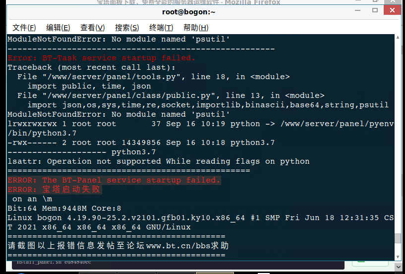

系统版本:linux  麒麟v10国防版
问题描述:宝塔启动失败

您好,您这个是模块没有安装到,所以启动失败了。您那边在服务器命令行下执行下面命令安装下模块看看
  1. btpip install psutil
  2. bt 1

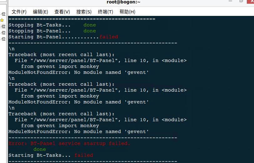

提示:
Traceback (most recent call last) :File "/www/server/panel/BT-Panel",line 10, in <module>
from gevent import monkey
ModuleNotFoundError: No module named 'gevent!
File "/www/server/panel/BT-Panel",line 10,in <module>from gevent import monkeyModuleNotFoundError: No module named 'geventn
Iraceback (most recent call last) :File "/www/server/panel/BT-Panel",line 10,in <module>from gevent import monkeyModuleNotFoundError: No module named' gevent!

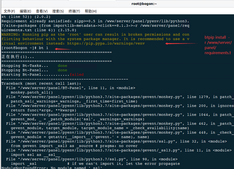

  1. btpip install  -r /www/server/panel/requirements.txt
发表于 2023-9-19 11:35:05 | 显示全部楼层
谢花郎 发表于 2023-9-18 17:26
您直接在命令行下执行下面命令:
还是不行 。提示如下
WARNING: Running pip as the 'root' user can result in broken permissions and conflicting behaviour with the system package manager. It is recommended to use a virtual environment instead: https://pip.pypa.io/warnings/venv
并且 运行 bt 1 还是启动不了
发表于 2023-9-19 11:38:34 | 显示全部楼层
宝塔用户_ezyevh 发表于 2023-9-19 11:35
还是不行 。提示如下
WARNING: Running pip as the 'root' user can result in broken permissions and co ...
还是缺少了python模块的问题,根据No module named 'ssl'错误找下对应的模块进行安装
