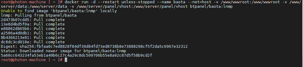

docker run -d --restart unless-stopped --name baota --net=host -v /www/wwwroot:/www/wwwroot -v /www/server/data:/www/server/data -v /www/server/panel/vhost:/www/server/panel/vhost btpanel/baota:lnmp
Unable to find image 'btpanel/baota:lnmp' locally
lnmp: Pulling from btpanel/baota
2d473b07cdd5: Pull complete
13e8d4bd5f0a: Pull complete
e88862d865b6: Pull complete
a2586a4d0db1: Pull complete
8b4366213e81: Pull complete
dc8dc3cd018e: Pull complete
Digest: sha256:fbfaa0c7ed8828f84df39d84fd73ed8738b8e73888298cf5f2da5c6967e32312
Status: Downloaded newer image for btpanel/baota:lnmp
5a60cc643234fa53eb1a49b6c27c4a29c8dc509706b55e8a92c87d5f58b9cd2f

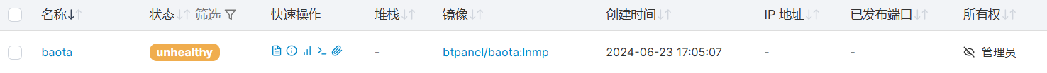

启动容器提示unhealthy错误

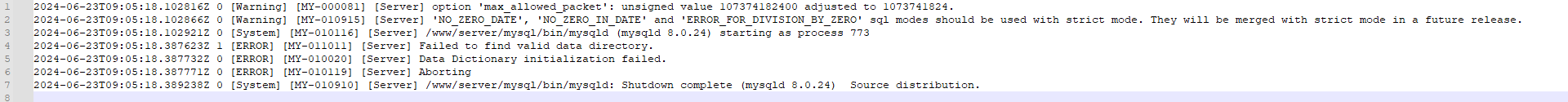

"/www/server/data/photon-machine.err" 发不了内容只能发图 4.png

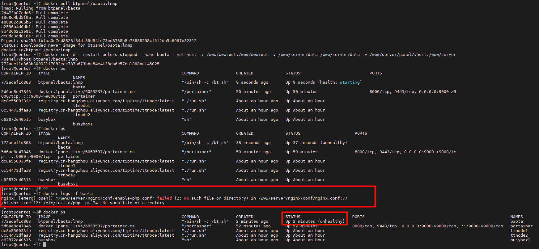

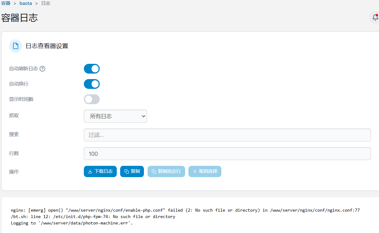

发表于 2024-7-15 11:44:43 | 显示全部楼层
您好,nginx:打开“/www/server/nginx/conf/enable-php.conf" 失败(2:没有这样的文件或目录)在/www/server/nginx/conf/nginX.conf:77/bt.sh:第12行:
您这边应该是配置的时候有误导致的,您看检查一下nginx.conf的第77行所写的内容
