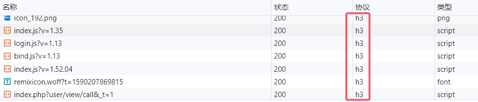

宝塔配置站点启用SSL之后默认配置如下:
server
                listen 80;
    listen 443 ssl;
    listen 443 quic reuseport;
    http2 on;
    server_name h.a.com;
    index index.php index.html index.htm default.php default.htm default.html;
    root /www/wwwroot/h_a_com;
    #CERT-APPLY-CHECK--START
    # 用于SSL证书申请时的文件验证相关配置 -- 请勿删除
    include /www/server/panel/vhost/nginx/well-known/h.a.com.conf;
    #CERT-APPLY-CHECK--END
    #SSL-START SSL相关配置,请勿删除或修改下一行带注释的404规则
    #error_page 404/404.html;
    #HTTP_TO_HTTPS_START
    if ($server_port !~ 443){
        rewrite ^(/.*)$ https://$host$1 permanent;
    #HTTP_TO_HTTPS_END
    ssl_certificate    /www/server/panel/vhost/cert/h.a.com/fullchain.pem;
    ssl_certificate_key    /www/server/panel/vhost/cert/h.a.com/privkey.pem;
    ssl_protocols TLSv1.1 TLSv1.2 TLSv1.3;
    ssl_ciphers EECDH+CHACHA20:EECDH+CHACHA20-draft:EECDH+AES128:RSA+AES128:EECDH+AES256:RSA+AES256:EECDH+3DES:RSA+3DES:!MD5;
    ssl_prefer_server_ciphers on;
    ssl_session_tickets on;
    ssl_session_cache shared:SSL:10m;
    ssl_session_timeout 10m;
    add_header Strict-Transport-Security "max-age=31536000";
    add_header Alt-Svc 'quic=":443"; h3=":443"; h3-29=":443"; h3-27=":443";h3-25=":443"; h3-T050=":443"; h3-Q050=":443";h3-Q049=":443";h3-Q048=":443"; h3-Q046=":443"; h3-Q043=":443"';
    error_page 497  https://$host$request_uri;
    #SSL-END
    #ERROR-PAGE-START  错误页配置,可以注释、删除或修改
    error_page 404 /404.html;
    #error_page 502 /502.html;
    #ERROR-PAGE-END
    #PHP-INFO-START  PHP引用配置,可以注释或修改
    include enable-php-80.conf;
    #PHP-INFO-END
    #REWRITE-START URL重写规则引用,修改后将导致面板设置的伪静态规则失效
    include /www/server/panel/vhost/rewrite/h.a.com.conf;
    #REWRITE-END
    #禁止访问的文件或目录
    location ~ ^/(\.user.ini|\.htaccess|\.git|\.env|\.svn|\.project|LICENSE|README.md)
        return 404;
    #一键申请SSL证书验证目录相关设置
    location ~ \.well-known{
        allow all;
    #禁止在证书验证目录放入敏感文件
    if ( $uri ~ "^/\.well-known/.*\.(php|jsp|py|js|css|lua|ts|go|zip|tar\.gz|rar|7z|sql|bak)$" ) {
        return 403;
    location ~ .*\.(gif|jpg|jpeg|png|bmp|swf)$
        expires      30d;
        error_log /dev/null;
        access_log /dev/null;
    location ~ .*\.(js|css)?$
        expires      12h;
    access_log  /www/wwwlogs/h.a.com.log;
    error_log  /www/wwwlogs/h.a.com.error.log;
这个配置就会如你所述一样的现象,修改为
server
        listen 80;
    listen 443 ssl;
    http2 on;
    #HTTP_TO_HTTPS_END
    #add_header Alt-Svc 'quic=":443"; h3=":443"; h3-29=":443"; h3-27=":443";h3-25=":443"; h3-T050=":443"; h3-Q050=":443";h3-Q049=":443";h3-Q048=":443"; h3-Q046=":443"; h3-Q043=":443"';
    add_header Alt-Svc 'h3=":443"; ma=86400';
    #SSL-END
    #ERROR-PAGE-END
    #PHP-INFO-END
    #REWRITE-END
    #禁止访问的文件或目录
        return 404;
    #一键申请SSL证书验证目录相关设置
        allow all;
    #禁止在证书验证目录放入敏感文件
        return 403;
        expires      30d;
        expires      12h;
即可显示H3,添加部分如下:
1. 添加:add_header Alt-Svc 'h3=":443"; ma=86400';
2.在如上的这行上面的一行 add_header Alt-Svc 'quic=":443"; h3=":443"; h3-29=":443"; h3-27=":443";h3-25=":443"; h3-T050=":443"; h3-Q050=":443";h3-Q049=":443";h3-Q048=":443"; h3-Q046=":443"; h3-Q043=":443"';注释掉或是不注释掉都可以
浏览器访问
注意一定要放行:UDP 443端口。
