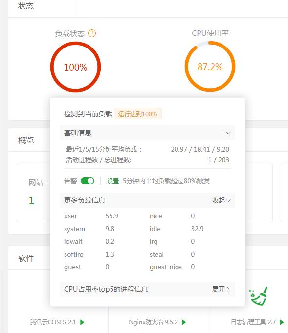

每天都会出3-4次负载100%的情况,每次时间约10分钟,这个时间过后就又恢复正常了,我在这里也搜遍了也没找到什么好的解决方案,在此请教一下老师到底怎样才能彻底解决。

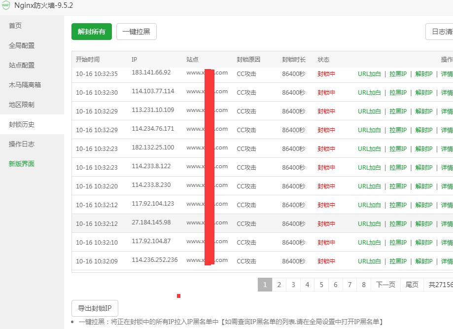

现在又恢复正常了,我在Nginx防火墙查看有CC攻击的记录

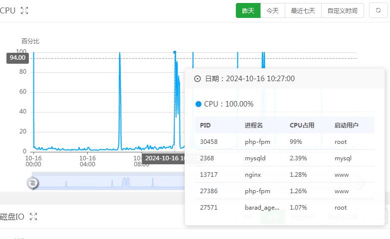

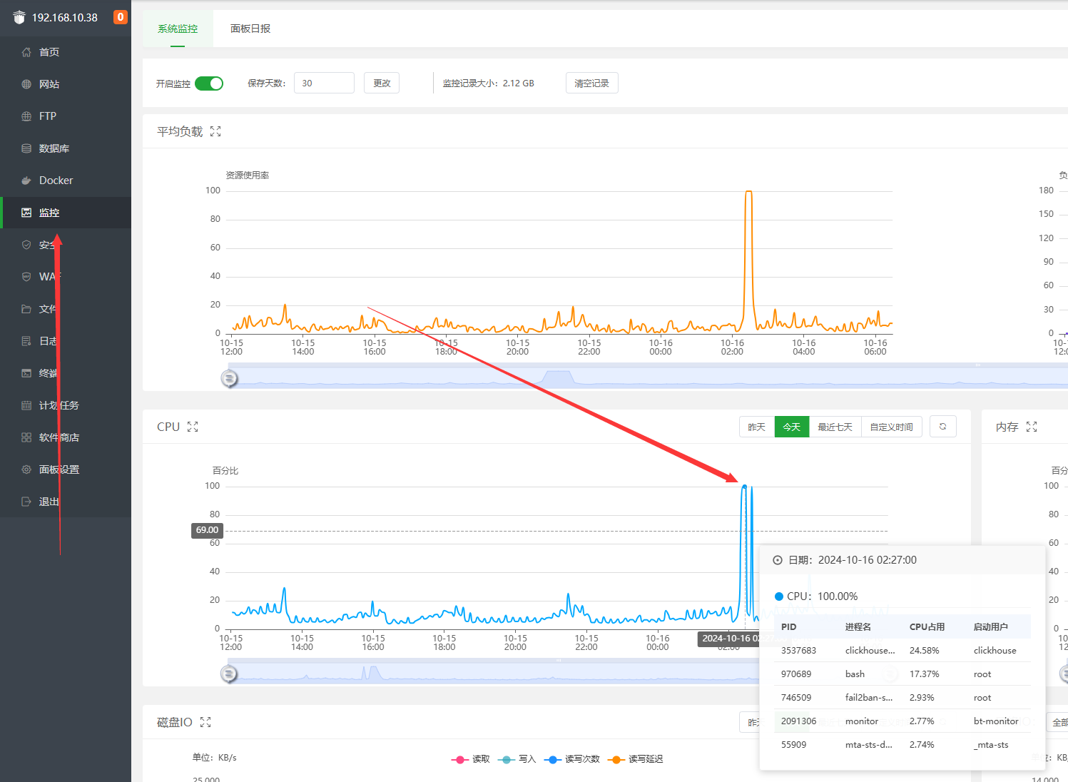

您好,打开监控,把鼠标放在负载比较高的地方,看看是什么进程,截图发出来

您好,打开监控,把鼠标放在负载比较高的地方,看看是什么进程,截图发出来 ...

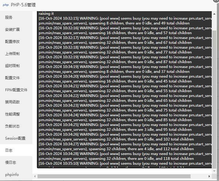

发表于 2024-10-17 08:37:35 | 显示全部楼层

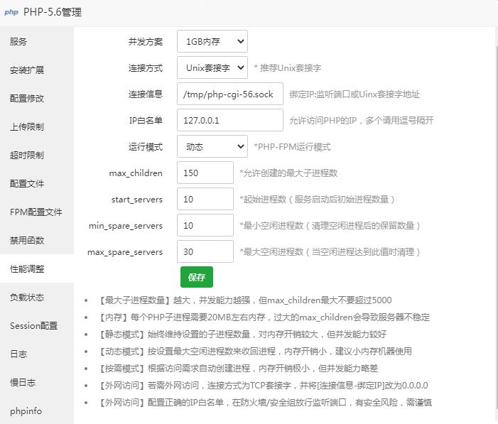

[16-Oct-2024 10:32:15] WARNING: [pool www] seems busy (you may need to increase pm.start_servers, or pm.min/max_spare_servers), spawning 8 children, there are 0 idle, and 49 total children
[16-Oct-2024 10:32:16] WARNING: [pool www] seems busy (you may need to increase pm.start_servers, or pm.min/max_spare_servers), spawning 16 children, there are 0 idle, and 57 total children
[16-Oct-2024 10:32:17] WARNING: [pool www] seems busy (you may need to increase pm.start_servers, or pm.min/max_spare_servers), spawning 32 children, there are 0 idle, and 67 total children
[16-Oct-2024 10:32:18] WARNING: [pool www] seems busy (you may need to increase pm.start_servers, or pm.min/max_spare_servers), spawning 32 children, there are 0 idle, and 77 total children
[16-Oct-2024 10:32:19] WARNING: [pool www] seems busy (you may need to increase pm.start_servers, or pm.min/max_spare_servers), spawning 32 children, there are 0 idle, and 87 total children
[16-Oct-2024 10:34:19] WARNING: [pool www] seems busy (you may need to increase pm.start_servers, or pm.min/max_spare_servers), spawning 8 children, there are 0 idle, and 37 total children
[16-Oct-2024 10:34:20] WARNING: [pool www] seems busy (you may need to increase pm.start_servers, or pm.min/max_spare_servers), spawning 16 children, there are 0 idle, and 45 total children
[16-Oct-2024 10:34:21] WARNING: [pool www] seems busy (you may need to increase pm.start_servers, or pm.min/max_spare_servers), spawning 32 children, there are 0 idle, and 55 total children
[16-Oct-2024 10:34:22] WARNING: [pool www] seems busy (you may need to increase pm.start_servers, or pm.min/max_spare_servers), spawning 32 children, there are 0 idle, and 65 total children
[16-Oct-2024 10:34:23] WARNING: [pool www] seems busy (you may need to increase pm.start_servers, or pm.min/max_spare_servers), spawning 32 children, there are 0 idle, and 75 total children
[16-Oct-2024 10:34:24] WARNING: [pool www] seems busy (you may need to increase pm.start_servers, or pm.min/max_spare_servers), spawning 32 children, there are 0 idle, and 85 total children
[16-Oct-2024 10:34:25] WARNING: [pool www] seems busy (you may need to increase pm.start_servers, or pm.min/max_spare_servers), spawning 32 children, there are 3 idle, and 95 total children
[16-Oct-2024 10:34:26] WARNING: [pool www] seems busy (you may need to increase pm.start_servers, or pm.min/max_spare_servers), spawning 32 children, there are 0 idle, and 102 total children
[16-Oct-2024 10:34:27] WARNING: [pool www] seems busy (you may need to increase pm.start_servers, or pm.min/max_spare_servers), spawning 32 children, there are 4 idle, and 112 total children
[16-Oct-2024 10:34:28] WARNING: [pool www] seems busy (you may need to increase pm.start_servers, or pm.min/max_spare_servers), spawning 32 children, there are 0 idle, and 118 total children
[16-Oct-2024 10:35:10] WARNING: [pool www] seems busy (you may need to increase pm.start_servers, or pm.min/max_spare_servers), spawning 8 children, there are 0 idle, and 98 total children
[16-Oct-2024 10:35:11] WARNING: [pool www] seems busy (you may need to increase pm.start_servers, or pm.min/max_spare_servers), spawning 16 children, there are 0 idle, and 106 total children
[16-Oct-2024 10:35:12] WARNING: [pool www] seems busy (you may need to increase pm.start_servers, or pm.min/max_spare_servers), spawning 32 children, there are 0 idle, and 116 total children
[16-Oct-2024 10:35:13] WARNING: [pool www] seems busy (you may need to increase pm.start_servers, or pm.min/max_spare_servers), spawning 32 children, there are 0 idle, and 126 total children
[16-Oct-2024 10:35:14] WARNING: [pool www] seems busy (you may need to increase pm.start_servers, or pm.min/max_spare_servers), spawning 32 children, there are 0 idle, and 136 total children
[16-Oct-2024 10:35:15] WARNING: [pool www] seems busy (you may need to increase pm.start_servers, or pm.min/max_spare_servers), spawning 32 children, there are 0 idle, and 146 total children
[16-Oct-2024 10:35:16] WARNING: [pool www] server reached pm.max_children setting (150), consider raising it
发表于 2024-10-17 08:47:05 | 显示全部楼层
这是php性能截图
