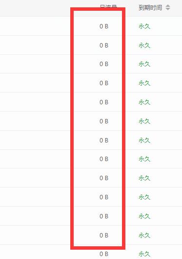

问题描述:日流量不显示
升级后,日流量显示已经安装成功,但是不显示。从9.8升级了3台,有CentOS 7.9,CentOS 7.6两台。有一台7.6可以显示。一台7.6,7.9均布显示。不知道咋回事。。。。如何修复?

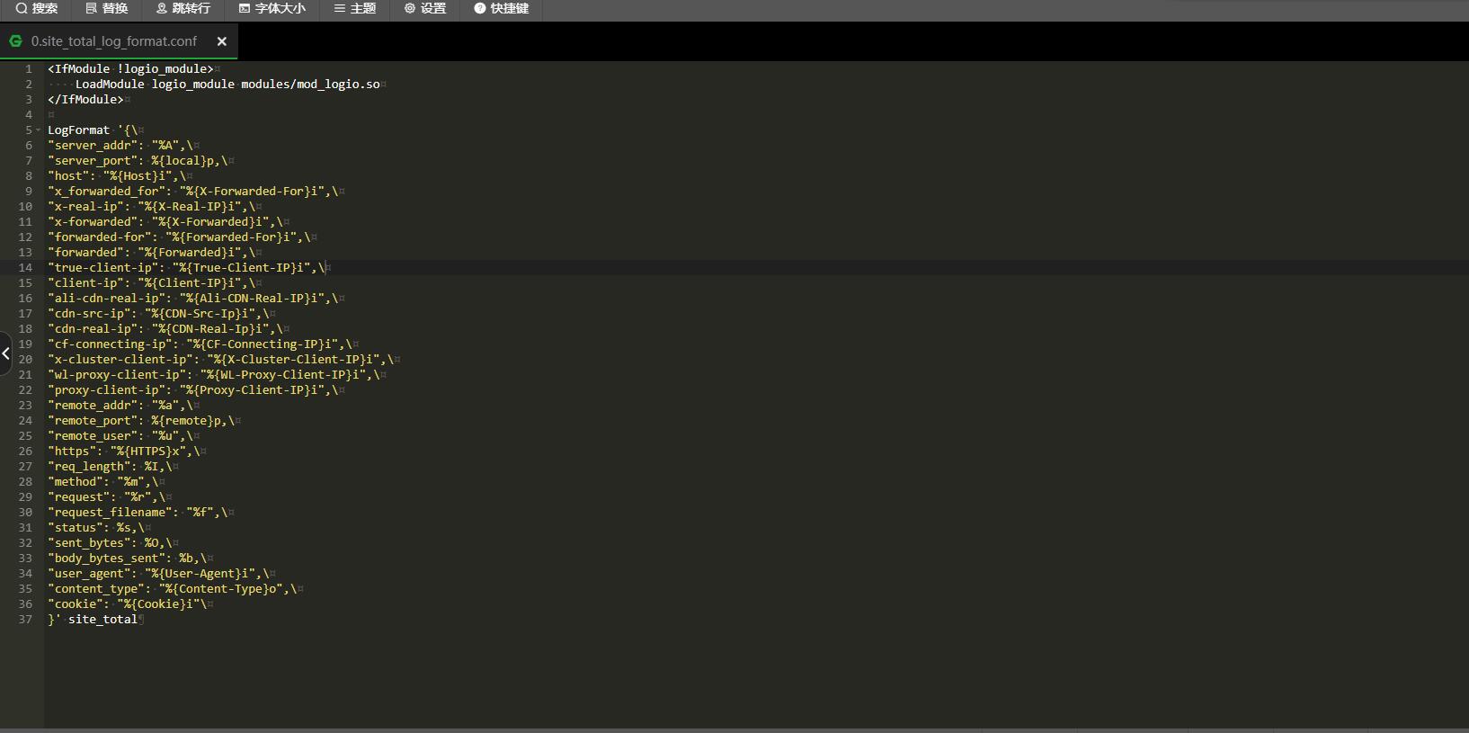

发表于 2025-10-15 21:37:31 | 显示全部楼层
没有0.site_total_map.conf文件
只有0.site_total_log_format.conf,配置如下
  1. <IfModule !logio_module>
  2.     LoadModule logio_module modules/mod_logio.so
  3. </IfModule>
  4. LogFormat '{\
  5. "server_addr": "%A",\
  6. "server_port": %{local}p,\
  7. "host": "%{Host}i",\
  8. "x_forwarded_for": "%{X-Forwarded-For}i",\
  9. "x-real-ip": "%{X-Real-IP}i",\
  10. "x-forwarded": "%{X-Forwarded}i",\
  11. "forwarded-for": "%{Forwarded-For}i",\
  12. "forwarded": "%{Forwarded}i",\
  13. "true-client-ip": "%{True-Client-IP}i",\
  14. "client-ip": "%{Client-IP}i",\
  15. "ali-cdn-real-ip": "%{Ali-CDN-Real-IP}i",\
  16. "cdn-src-ip": "%{CDN-Src-Ip}i",\
  17. "cdn-real-ip": "%{CDN-Real-Ip}i",\
  18. "cf-connecting-ip": "%{CF-Connecting-IP}i",\
  19. "x-cluster-client-ip": "%{X-Cluster-Client-IP}i",\
  20. "wl-proxy-client-ip": "%{WL-Proxy-Client-IP}i",\
  21. "proxy-client-ip": "%{Proxy-Client-IP}i",\
  22. "remote_addr": "%a",\
  23. "remote_port": %{remote}p,\
  24. "remote_user": "%u",\
  25. "https": "%{HTTPS}x",\
  26. "req_length": %I,\
  27. "method": "%m",\
  28. "request": "%r",\
  29. "request_filename": "%f",\
  30. "status": %s,\
  31. "sent_bytes": %O,\
  32. "body_bytes_sent": %b,\
  33. "user_agent": "%{User-Agent}i",\
  34. "content_type": "%{Content-Type}o",\
  35. "cookie": "%{Cookie}i"\
  36. }' site_total

发表于 2025-10-16 16:16:05 | 显示全部楼层
这个配置看起来没有问题,可以看下apache的主配置

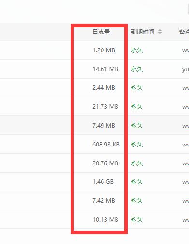

nginx换个版本!发现问题时1.24版本为0,两台机器分别切到1.22、1.26版本正常,也许切换版本就能好,没再深入测试。可以参考下
发表于 2025-12-6 02:38:43 | 显示全部楼层
重启Nginx或者阿帕奇试试,我这边Nginx -Tengine2.2.4重启了就正常显示了
