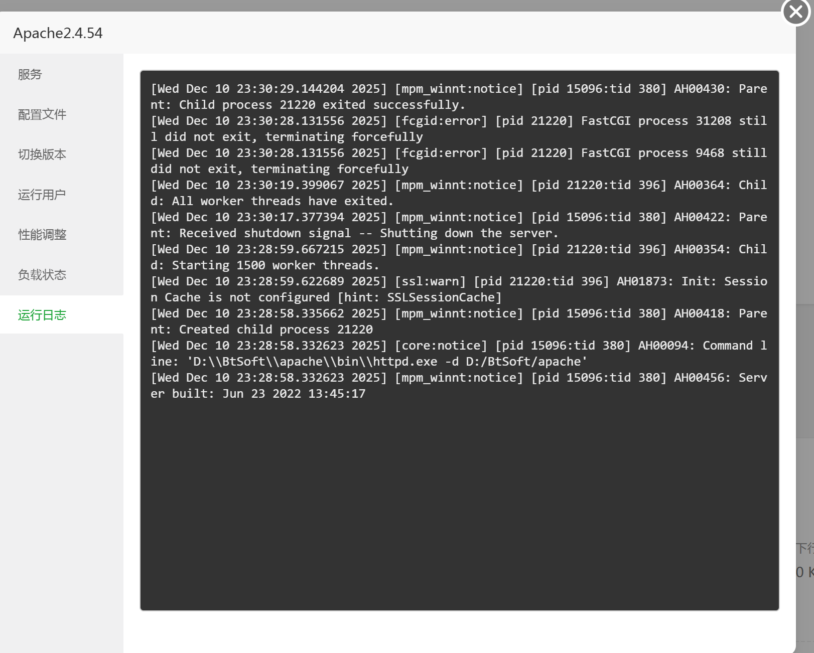

面板、插件版本:宝塔面版8.4.9,Apache 2.4.54
[Wed Dec 10 23:30:29.144204 2025] [mpm_winnt:notice] [pid 15096:tid 380] AH00430: Parent: Child process 21220 exited successfully.[Wed Dec 10 23:30:28.131556 2025] [fcgid:error] [pid 21220] FastCGI process 31208 still did not exit, terminating forcefully[Wed Dec 10 23:30:28.131556 2025] [fcgid:error] [pid 21220] FastCGI process 9468 still did not exit, terminating forcefully[Wed Dec 10 23:30:19.399067 2025] [mpm_winnt:notice] [pid 21220:tid 396] AH00364: Child: All worker threads have exited.[Wed Dec 10 23:30:17.377394 2025] [mpm_winnt:notice] [pid 15096:tid 380] AH00422: Parent: Received shutdown signal -- Shutting down the server.[Wed Dec 10 23:28:59.667215 2025] [mpm_winnt:notice] [pid 21220:tid 396] AH00354: Child: Starting 1500 worker threads.[Wed Dec 10 23:28:59.622689 2025] [ssl:warn] [pid 21220:tid 396] AH01873: Init: Session Cache is not configured [hint: SSLSessionCache][Wed Dec 10 23:28:58.335662 2025] [mpm_winnt:notice] [pid 15096:tid 380] AH00418: Parent: Created child process 21220[Wed Dec 10 23:28:58.332623 2025] [core:notice] [pid 15096:tid 380] AH00094: Command line: 'D:\\BtSoft\\apache\\bin\\httpd.exe -d D:/BtSoft/apache'[Wed Dec 10 23:28:58.332623 2025] [mpm_winnt:notice] [pid 15096:tid 380] AH00456: Server built: Jun 23 2022 13:45:17
系统版本:windows宝塔面版
apache运行后自动停止

同样的问题,我已经解决,
1.首先在宝塔面板内把apache关了,然后查看80端口是否被占用
netstat -ano | findstr :80
2.我这边看到的结果是这样的,
  1. C:\Users\Administrator>netstat -ano | findstr :80
  2.   TCP    0.0.0.0:80             0.0.0.0:0              LISTENING       14632
  3.   TCP    192.168.13.154:49670   100.64.205.163:80      ESTABLISHED     3148
  4.   TCP    [::]:80                [::]:0                 LISTENING       14632
等于说在apache还没启动的时候,就已经有端口占用了,14632端口,
接下来看14632端口具体是什么
wmic process where "ProcessId=14632" get ProcessId,Name,CommandLine
  1. C:\Users\Administrator>wmic process where "ProcessId=14632" get ProcessId,Name,CommandLine
  2. CommandLine                                     Name       ProcessId
  3. "C:\BtSoft\apache\bin\httpd.exe" -k runservice  httpd.exe  14632
这里可以看到,PID 14632 也是 httpd.exe,路径同样是 C:\BtSoft\apache\bin\httpd.exe
等于说有两个 Apache 实例,一个是PID 6252(主进程) + 15912(子进程)
另一个是PID 14632(独立 httpd 进程),它先占用了 80 端口
这就会导致第二个 Apache(6252)启动时,实际上无法真正绑定 80 端口(因为已被 14632 占用)
几分钟后,可能因健康检查失败、父进程检测到异常,或宝塔尝试的主动健康检查机制清理重复进程啥的,,主动发出了 shutdown 信号
