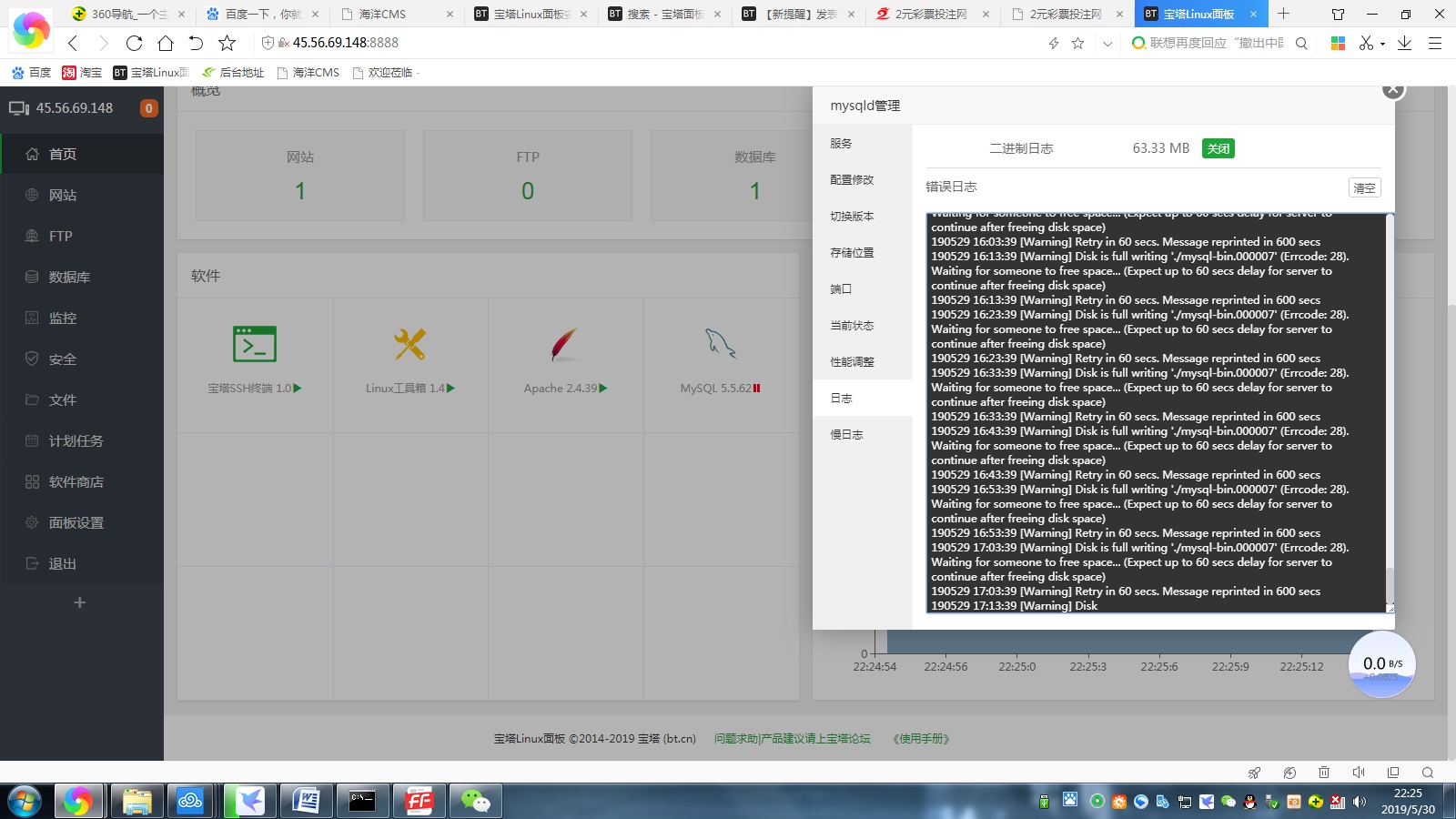

Retry in 60 secs. Message reprinted in 600 secs
190529 17:03:39 [Warning] Disk is full writing './mysql-bin.000007' (Errcode: 28). Waiting for someone to free space... (Expect up to 60 secs delay for server to continue after freeing disk space)

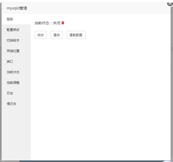

提示磁盘空间已经满了,数据库服务起不来了· 不知道是要到哪里清理?
