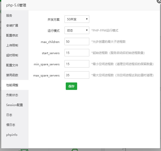

[26-Jul-2019 10:02:30] WARNING: [pool www] seems busy (you may need to increase pm.start_servers, or pm.min/max_spare_servers), spawning 8 children, there are 11 idle, and 33 total children
[26-Jul-2019 10:23:08] WARNING: [pool www] seems busy (you may need to increase pm.start_servers, or pm.min/max_spare_servers), spawning 8 children, there are 0 idle, and 42 total children
[26-Jul-2019 10:23:09] WARNING: [pool www] server reached pm.max_children setting (50), consider raising it
服务器配置是阿里云的1H2G
php性能设置的是50并发,运行微擎和两个wordpress
这种配置可以改成100并发的方案吗?用不用升级配置?
求优化建议!!

发表于 2019-7-26 11:30:31 | 显示全部楼层
建议不要提高,而是应该降低。
并发指的是同时访问的用户数量。
正常情况博客同时访问的数量不会超过60(被攻击除外),有的博客日IP都才几十而已。
1h1g建议尽量控制在30以内,避免服务器cpu满载。
