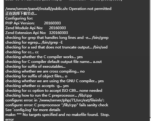

面板6.98 系统是CentOS Linux 7.6
发表于 2019-9-4 13:52:27 | 显示全部楼层
你看你的报错是写的权限不足,检查一下服务器权限呗
发表于 2019-9-4 14:22:32 | 显示全部楼层
查了下 权限啥的 正常的应该是,刚卸载了php
然后直接装不上了

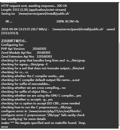

发表于 2019-9-4 15:12:40 | 显示全部楼层
谢花郎 发表于 2019-9-4 14:48
修复一下面板清除缓存后再试试
Configuring for:
PHP Api Version:         20160303
Zend Module Api No:      20160303
Zend Extension Api No:   320160303
checking for grep that handles long lines and -e... /bin/grep
checking for egrep... /bin/grep -E
checking for a sed that does not truncate output... /bin/sed
checking for cc... cc
checking whether the C compiler works... yes
checking for C compiler default output file name... a.out
checking for suffix of executables...
checking whether we are cross compiling... no
checking for suffix of object files... o
checking whether we are using the GNU C compiler... yes
checking whether cc accepts -g... yes
checking for cc option to accept ISO C89... none needed
checking how to run the C preprocessor... /lib/cpp
configure: error: in `/www/server/php/71/src/ext/fileinfo':
configure: error: C preprocessor "/lib/cpp" fails sanity check
See `config.log' for more details
make: *** No targets specified and no makefile found.  Stop.
error
发表于 2019-9-4 15:16:04 | 显示全部楼层
修复一下面板清除缓存后再试试
fileinfo和memcached都装不上
但是opcache这个扩展却安装成功了
