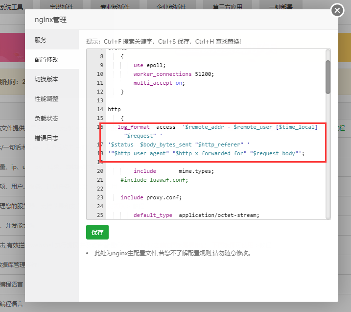

如果只是记录POST的话。只需要加一个参数$request_body
如下:
  1. log_format access '$remote_addr - $remote_user [$time_local] "$request" '
  2. '$status  $body_bytes_sent "$http_referer" '
  3. '"$http_user_agent" "$http_x_forwarded_for" "$request_body"';

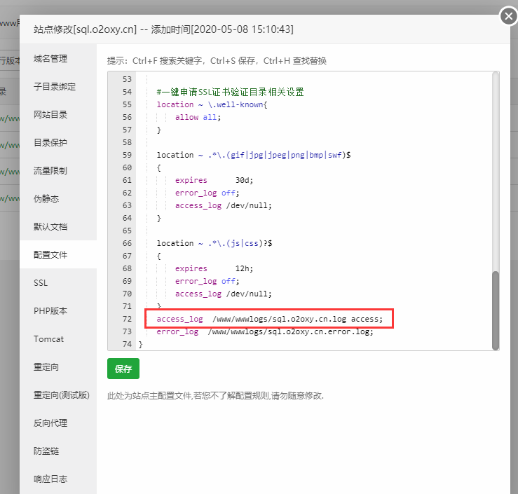

然后找到网站的配置文件
点击保存即可。访问之后呢,返回的日志格式为
  1. 192.168.10.1 - - [06/Aug/2020:15:55:41 +0800] "GET / HTTP/2.0" 304  0 "-" "Mozilla/5.0 (Windows NT 10.0; Win64; x64) AppleWebKit/537.36 (KHTML, like Gecko) Chrome/84.0.4147.105 Safari/537.36" "-" "-"
  2. 192.168.10.1 - - [06/Aug/2020:16:01:56 +0800] "POST / HTTP/2.0" 405  552 "-" "Mozilla/5.0 (Windows NT 10.0; Win64; x64) AppleWebKit/537.36 (KHTML, like Gecko) Chrome/84.0.4147.105 Safari/537.36" "-" "id=1"
POST 的日志的记录会在最后面。这样不影响大多数数据分析工具。
