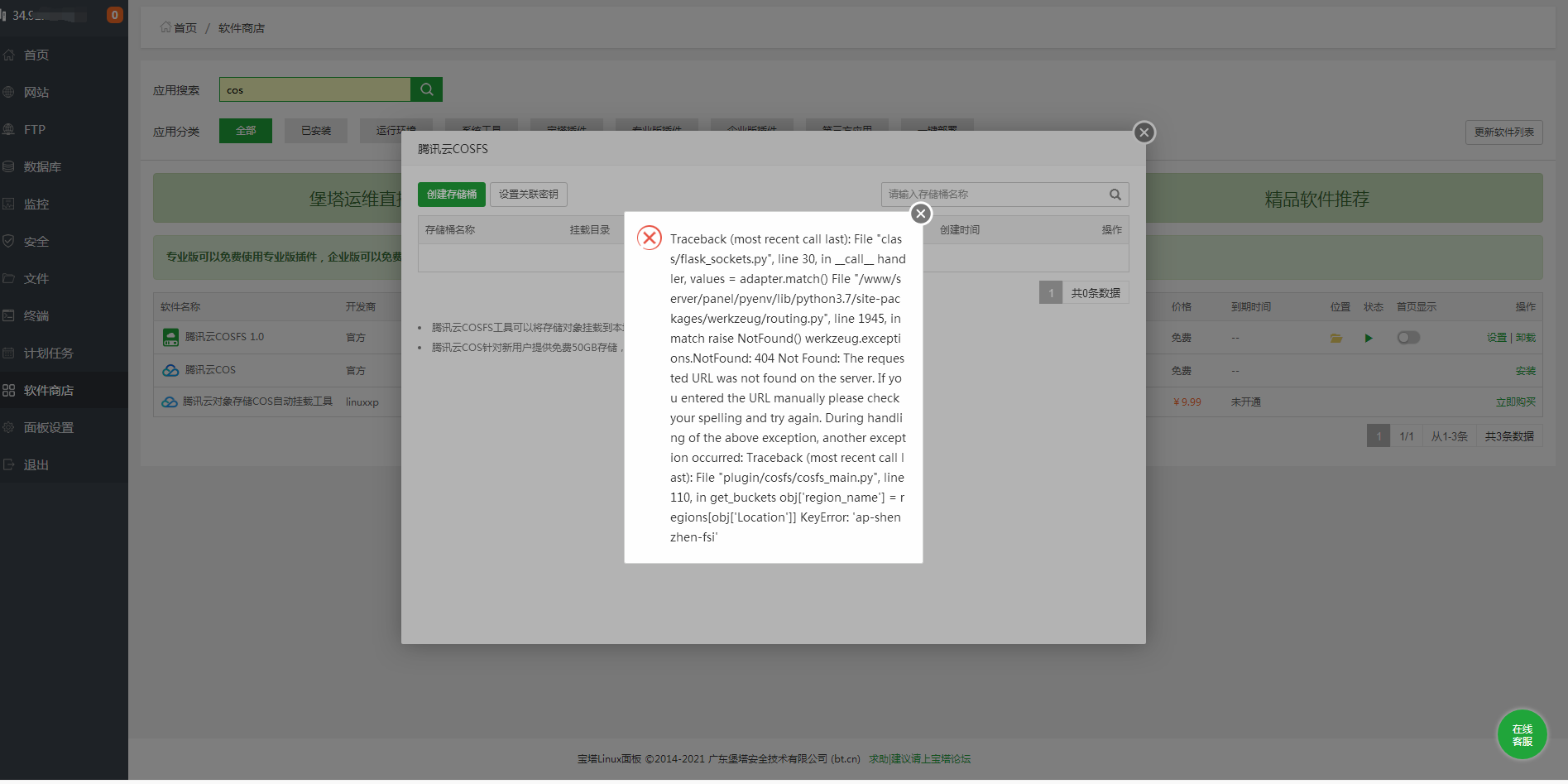

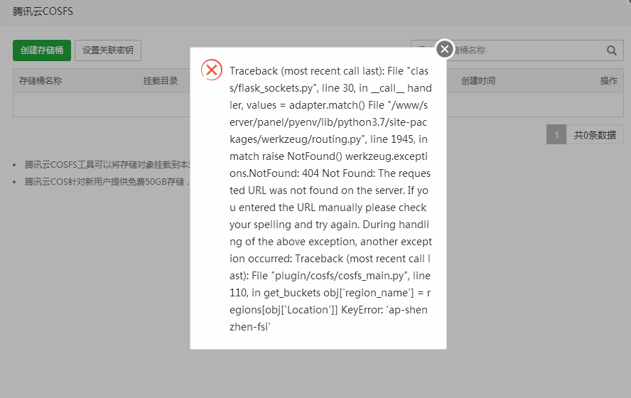

腾讯轻量云 无法使用 coscf Traceback (most recent call last): File "class/flask_sockets.py", line 30, in __call__ handler, values = adapter.match() File "/www/server/panel/pyenv/lib/python3.7/site-packages/werkzeug/routing.py", line 1945, in match raise NotFound() werkzeug.exceptions.NotFound: 404 Not Found: The requested URL was not found on the server. If you entered the URL manually please check your spelling and try again. During handling of the above exception, another exception occurred: Traceback (most recent call last): File "plugin/cosfs/cosfs_main.py", line 110, in get_buckets obj['region_name'] = regions[obj['Location']] KeyError: 'ap-shenzhen-fsi' 可以在宝塔正常新建 但是无法显示

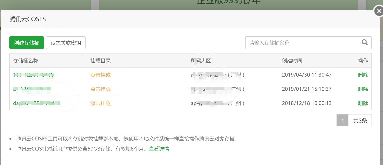

发表于 2021-2-22 15:44:59 | 显示全部楼层
金融区域资费与普通区域的不相同,所以金融区域未增加到插件里面导致报错的
