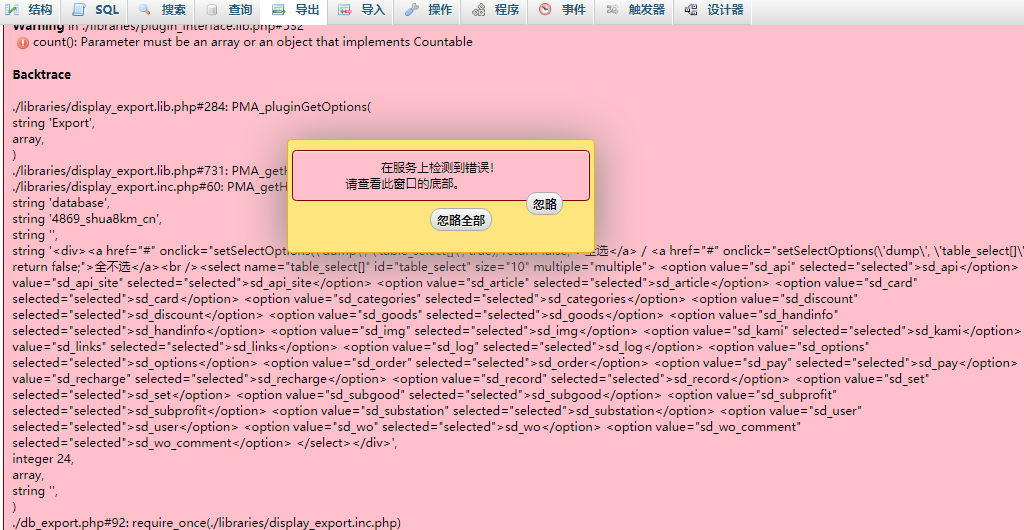

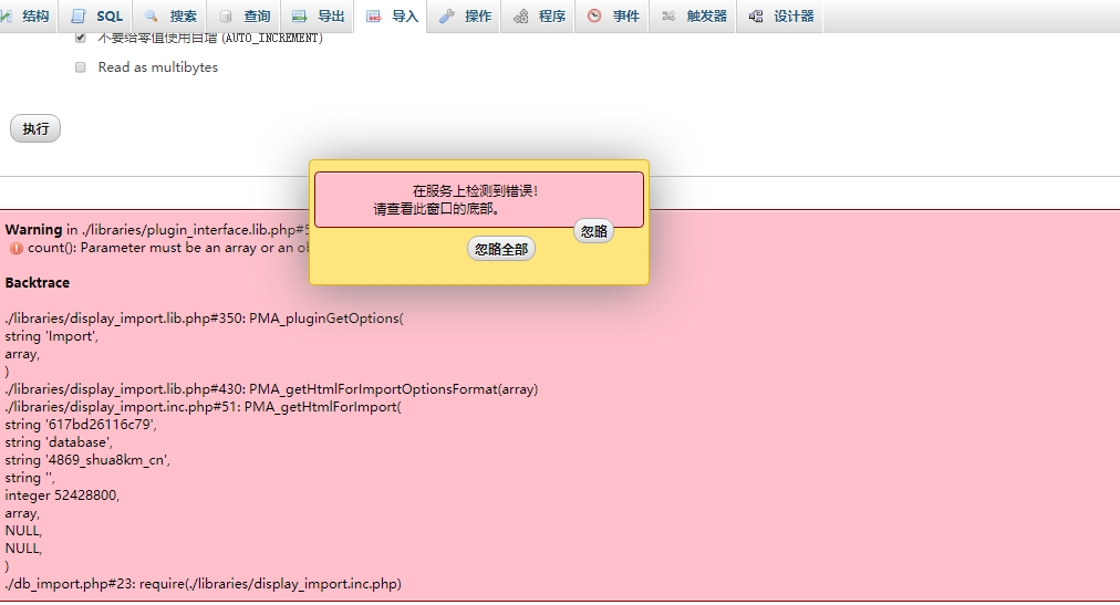

前几天 还正常 今天导入新网站数据库 出现错误,导出时候 发现也错误。

请切换对应的phpmyadmin和php版本使用,另外建议在面板导出数据库
  1. phpMyAdmin,又要重新去找对于的phpMyAdmin就很麻烦了哈,我这里简单整理下。
  2. phpMyAdmin5.0.0 Current version compatible with PHP 5.5 to 7.4 and MySQL 5.5 and newer.
  3. phpMyAdmin4.9.0 Current version compatible with PHP 5.5 to 7.3 and MySQL 5.5 and newer.
  4. phpMyAdmin4.8.0 Older version compatible with PHP 5.5 to 7.2 and MySQL 5.5 and newer. Was supported until June 4, 2019.
  5. phpMyAdmin4.6.0-4.7.0 Older version compatible with PHP 5.5 to 7.1 and MySQL 5.5 and newer. Was supported until April 1, 2017.
  6. phpMyAdmin4.5.0 Older version compatible with PHP 5.5 to 7.0 and MySQL 5.5. Was supported until April 1, 2016.
  7. phpMyAdmin4.4.0 Older version compatible with PHP 5.3.7 to 7.0 and MySQL 5.5. Was supported until October 1, 2016.
  8. phpMyAdmin4.1.0-4.3.0 Older version compatible with PHP 5.3 and MySQL 5.5. Was supported until October 1, 2015.
  9. phpMyAdmin4.0.0 Older version compatible with PHP 5.2 and MySQL 5. Does not support PHP 5.5 or newer. Was supported until April 1, 2017.

卸载现在的phpmyadmin然后装一个phpmyadmin5.0就可以了。php版本选7.3或者7.4,建议用7.4
发表于 2021-10-29 20:25:47 | 显示全部楼层
堡塔安全赤井秀一 发表于 2021-10-29 20:20
卸载现在的phpmyadmin然后装一个phpmyadmin5.0就可以了。php版本选7.3或者7.4,建议用7.4 ...
解决了 这个是啥问题
