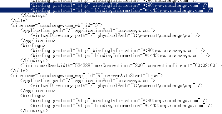

发表于 2017-11-25 23:21:51 | 显示全部楼层
1. 找到C:\Windows\system32\inetsrv\config\applicationHost.config
2. <binding protocol="http" bindingInformation="*:80:www.souchangw.com" />
     <binding protocol="https" bindingInformation="*:443:" />
修改成:
      <binding protocol="https" bindingInformation="*:443:www.souchangw.com" />
有几个域名就修改几个。设置N个,

发表于 2021-2-22 15:33:35 | 显示全部楼层
2.
这个也无效呀……
