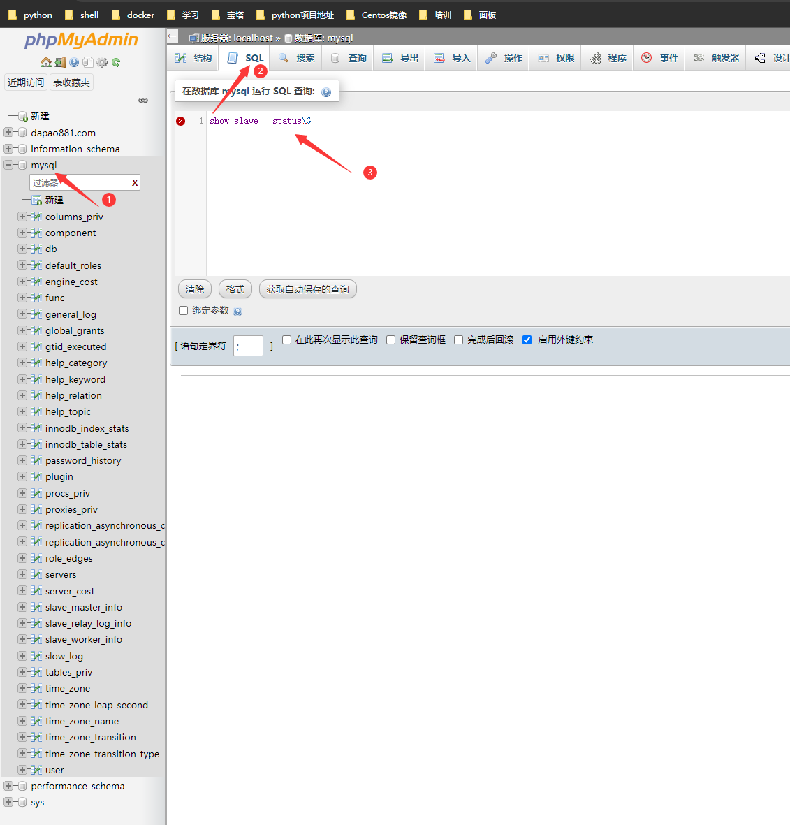

查杀大的.png 打开phpmyadmin,使用mysql这个库,然后执行我给的命令还不行的话,私信我您的Todesk远程连接码

SQL 查询:
show  slave status\G
MySQL 返回: 文档
#1064 - You have an error in your SQL syntax; check the manual that corresponds to your MySQL server version for the right syntax to use near '\G' at line 1
